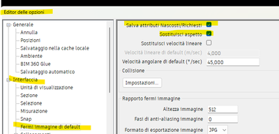

you need to go in the Navisworks options (N logo in the upper left corner)
Then go to Interface / viewpoints / check the first two checkboxes
Pardon the italian screenshot:

Yes this works for me, thanks for your answer.
