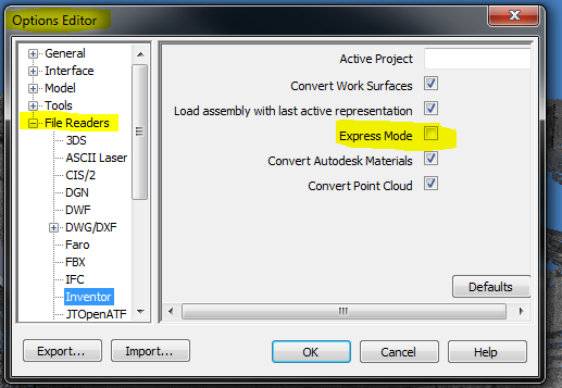

I found a solution/fix! Deactivate the 'Express Mode' setting in the options.
I had the same error with Navisworks Manage 2018 and Inventor 2017.
Manage would not load my main assembly, but would successfully load every single sub-assembly and part. Due to Frame assemblies, it contains approx. 200 parts, and Point Cloud Data.
I deactivated Express mode and it now works.

Did not work for me, removing Express Mode, but thanks for the tip. I never expected this to work though, because this error is so common, it happens anytime we have more complicated assemblies (mine now was upwards of 3363 components).
