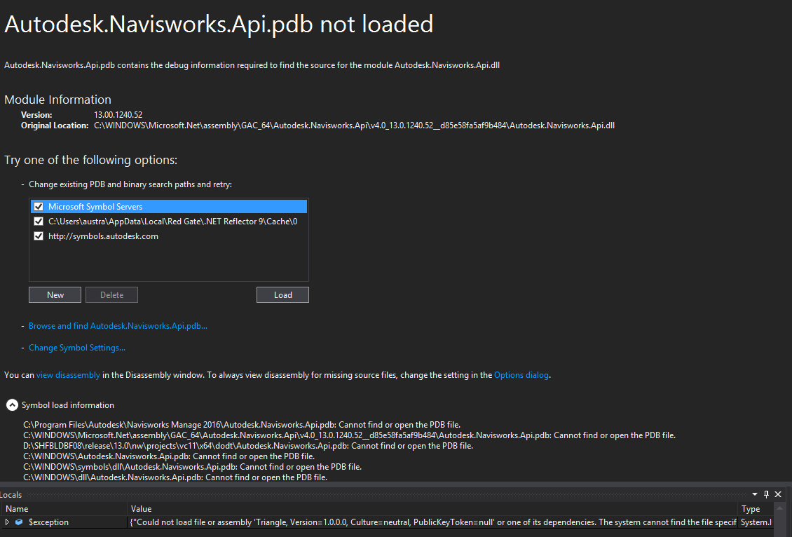

I am creating a Navisworks plugin that utilizes Triangle.Net to create a mesh from the locations of MTEXT items. When I run the plugin in Navisworks I get this error.
The project builds fine and I get this error while debugging. The exception at the bottom says it can't load Triangle, but I'm not sure why.
I'll insert my code as well.

I found the issue. I did not build Triangle.dll in the Navisworks 2016 directory. I figured this out by using Sysinternals Process Monitor to find the failed processes.

This is a bad solution that only works for your project. The fact is that the PDB files are not provided on Autodesk's Symbol servers and prevent proper debugging. The only reason you managed to fix the issue is because you prevented Navisworks from crashing.

I put the external library dll in the Navisworks.exe folder ("C:\Program Files\Autodesk\Navisworks Manage XXXX\") as a trial and it solved the problem.
Placing it in the Dependencies folder did not solve the problem in my environment.
If you want to place it in the Dependencies folder, you can set the PATH to "C:\Program Files\Autodesk\Navisworks\Manage XXXX\Dependencies" and pass it through.
I will note my case specifically.
I encountered this problem when using the JSON library (JSON.Net https://www.newtonsoft.com/json).
Specifically, I was able to work around the problem by placing "Newtonsoft.Json.dll" in "C:\Program Files\Autodesk\Navisworks Manage XXXX\".

I guess the issue is Newtonsoft.json.dll comes bundled with Navisworks - Navisworks uses it. It is placed in the root folder. You should be able to use that file if you can use the version provided by Autodesk that is.
