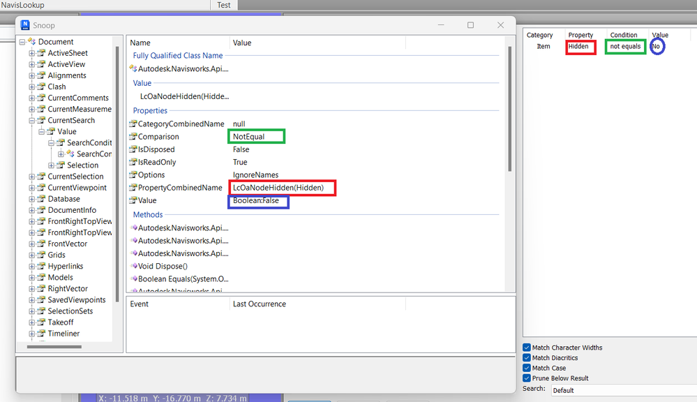

naveen.kumar.t
Autodesk Support
Autodesk Support
Hi @niels_deboer ,
I recommend using the NavisLookup tool(https://github.com/chuongmep/NavisLookup) to identify the correct values to use in your code.
Below are the steps I followed:
  1. Create the desired Search Conditions in Find Items via the Navisworks UI.
  2. Go to NavisLookupSnoop Active DocumentCurrent SearchValueSearch ConditionsSearch Condition[0].
  3. You will now see the values, as shown in the attached screenshot. Please see the attached screenshot
  4. Use these same values in the sample code as shown below.
  5. Ensure you are passing the correct data type into VariantData value. For example, if the value is a string, pass a string; if it is a boolean, pass a boolean.
  6. With this search condition, run a search on your document. It should return the same results as the Find Items.
Sample Code:
Document doc = Autodesk.Navisworks.Api.Application.ActiveDocument;
NamedConstant categoryCombinedName = null;
NamedConstant propertyCombinedName = new NamedConstant(DataPropertyNames.ItemHidden);
SearchConditionOptions options = SearchConditionOptions.IgnoreNames;
SearchConditionComparison comparison = SearchConditionComparison.NotEqual;
VariantData value = new VariantData(false);
SearchCondition searchCondition = new SearchCondition(categoryCombinedName,propertyCombinedName,options,comparison,value);
Search serach = new Search();
serach.Locations = SearchLocations.Descendants;
serach.SearchConditions.Add(searchCondition);
serach.Selection.SelectAll();
ModelItemCollection items = serach.FindAll(doc, true);
Naveen Kumar T
Developer Technical Services
Autodesk Developer Network

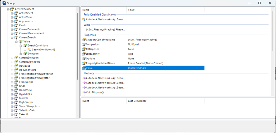

niels_deboer
Amazing this works! Thanks Naveen,
I finally managed to make the NotEqual filter and tested it on a small test sample, which seems to behave correctly.
I've installed Navislookup and found the properties and the following code works for a not equal condition.
Here is the code for the making the condition for a not equal filter.
NamedConstant category = new NamedConstant("LcSvF_Phasing", "Phasing");
NamedConstant property = new NamedConstant("Phase Created", "Phase Created");
SearchConditionOptions options = SearchConditionOptions.None;
SearchConditionComparison NotEqual = SearchConditionComparison.NotEqual;
VariantData target = new VariantData(targetValue.ToString()); // VariantData.FromDisplayString(targetValue.ToString());
condition = new SearchCondition(category, property, options, NotEqual, target)

    // Execute not equal search
    NamedConstant search_category = new NamedConstant(categoryName, categoryDisplayName); // see named constant in the documentation
    NamedConstant search_property = new NamedConstant(dataPropertyName, dataPropertyDisplayName);
    condition = new SearchCondition(search_category, search_property, options, NotEqual, target);
// Then add your script to apply the condition to select the items.
