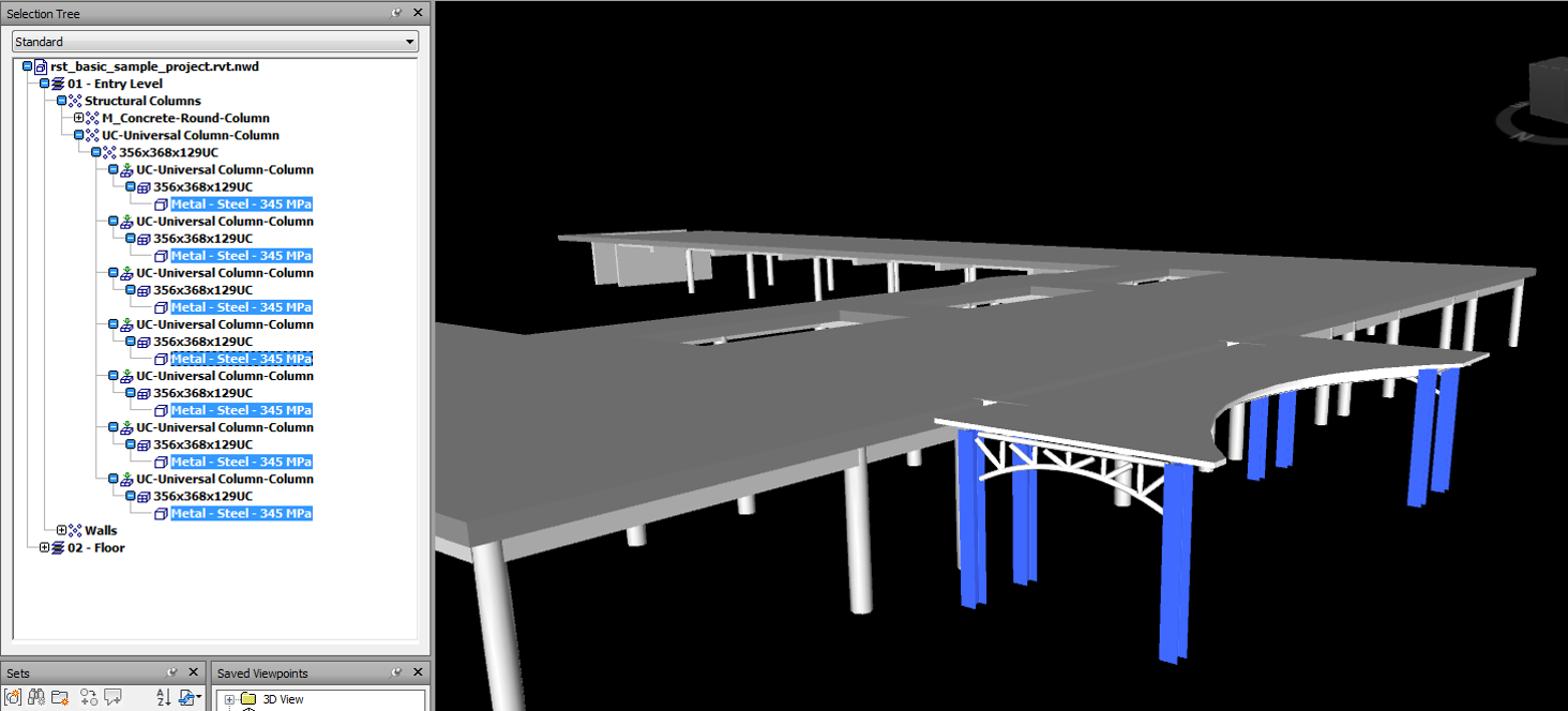

I am extracting primitives of the clicked modelitem to get points, edges, faces.
This works most of the time, but for some items the collection of fragments is not for the clicked item only, it is for multiple independant items in the tree. Is there a way to check the fragments are from the same object?
I am using this very simple code:
        Dim Itm As ModelItem = Autodesk.Navisworks.Api.Application.
            ActiveDocument.CurrentSelection.SelectedItems(0)
        Dim ItmPath As InwOaPath =
            ComApi.ComApiBridge.ToInwOaPath(Itm)
        For Each frag As InwOaFragment3 In ItmPath.Fragments 'this collection contains fragments from multiple items
            frag.GenerateSimplePrimitives(nwEVertexProperty.eNORMAL, Me)
            'Me is a class that implements InwSimplePrimitivesCB
        Next
In the picture below, if I try to extract the geometry for any of the selected item (in blue), it returns the fragments for all of them.
If I click any other item, it returns the fragments for the clicked object only...
Cheers,
Nic

I found this is actually an issue I have logged in the previous release: NW #14187. However it looks to me this is as designed.
behind the behavior: because the Fragments() function is getting hold of the node at the tail of the path, and then asking for the fragments for the node. This actually returns all the fragments for all instances of that node, so you get multi-fragments, not one.
I have not a good way to solve, but you could try to get parent of the selected item (assume it is the geometry node), and dump the fragments.
I will also check with our engineer team about #14187
Message 3 of 9
Sweet that fixed it. I suspected it had to do with instances.
I actually had to go higher in the tree, the first parent was still returning multiple instances.
so the very simple solution:
        While _Item.Instances.Count > 1
            _Item = _Item.Parent
        End While
        Dim Path As InwOaPath =
            ComApi.ComApiBridge.ToInwOaPath(_Item)
        For Each frag As InwOaFragment3 In Path.Fragments
        Next
thanks again,
