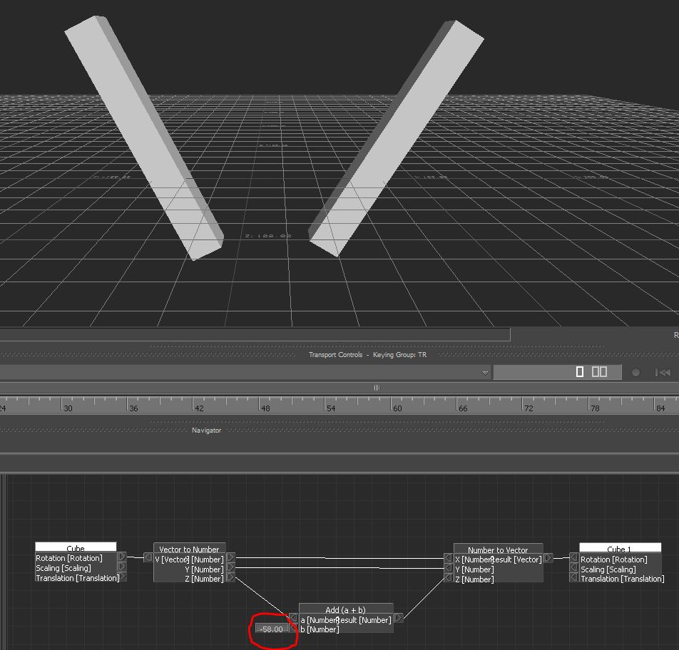

Hi Xatmo,
Try maybe something simpler like that:
Just take the rotation of the first cube, add your rotation offset (-58 on Z axis in this exemple) and plug it in the second cube rotation.
Cheers

In your graph, you take the Z rotation value of 'Cube' and subtract this same value, so the result will always be 0. So 'Cube' can never affect the rotation of you constrain object.
You always have to set somewhere the initial offsets between your two objects. It could be on values in the relation constraints , custom parameters, using another object...
Can you tell me in which context you want to setup a constrain like that ?
If you want to get or set the local transform on an object, right clic on the node and choose 'Local Transformations':
