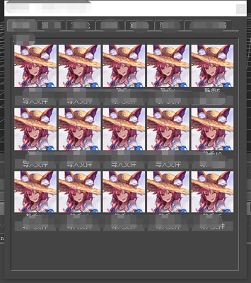

Now I have written a tap panel like this, but it needs a lot of code.
So I write a function to do that,

however, it seems something wrong, when I run this script,I got a button with wrong size and coordinate.
Will anyone give me some advice, please?
