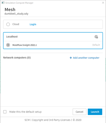

Hi, everyone. Could you please teach me about API?
I am using MoldFlow version 2021.1.
I am trying to automate a series of operations of simulation by using the API. In the API program, I am utilizing the "StudyDoc.MeshNow" or "StudyDoc.AnalyzeNow" commands, but these commands make an appearance window related to SCM below.
This window requires user operation to close. So, due to this window, the API program is stopped by waiting for user input.
I know that utilizing MDLmesher or "runstudy" utility can avoid using SCM but, the process that using them is slower because the definition of the injection process is complex.
So, is there any way to avoid the appearance of the window or control the window by API?

Hi @kimura.shinichiro ,
did you try this:
StudyDoc.MeshNow False
where the boolean is
aPrompts set False will prevent showing prompt on GUI
And:
Set StudyDoc = Synergy.StudyDoc()
StudyDoc.AnalyzeNow2 False, True, False
where the booleans are:
aCheck whether model checking is to be performed
aSolve whether the model solution needs to generated by the analysis
Let us know about the progress.

kimura.shinichiro
Hi, @Anonymous
Thank you for your reply.
I had done many tries and errors regarding this issue for a long time but, after I read your message, the issue has completely solved within one hour. I am so grateful for your help. Very very thank you.
