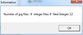

Results in:
I think this should do the job.
