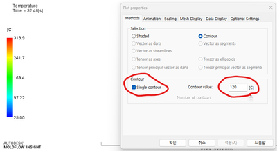

If anyone knows about Moldflow API Reference for Conture value, please let me know.
I would like to know the API references for the two options shown.
I searched for the contents of Plot and PlotMgr in the Synergy API referance but couldn't find it.

I think this is a limitation.
Could not find a solution for it.
When not finding help in Synergy API, recording a macro and review code could help.
When recording a macro for this scenario, there is no such plot attribute showing up, for setting temperature for contour.
Probably need to raise an enhancement request at Moldfow Ideas:

 It is correct that this reference does not exist.
It's not that I can't find it.
As you said, it was not recorded even if I used the Macro recording function.

But you can set the scale, so if you have a value you'd like (120C as shown above), you can set the min and max temp to 120C via a script.  It's possible to pull the transition value from the material data and use that as the min and max value.  Not the same, but I think it accomplishes the same thing.
