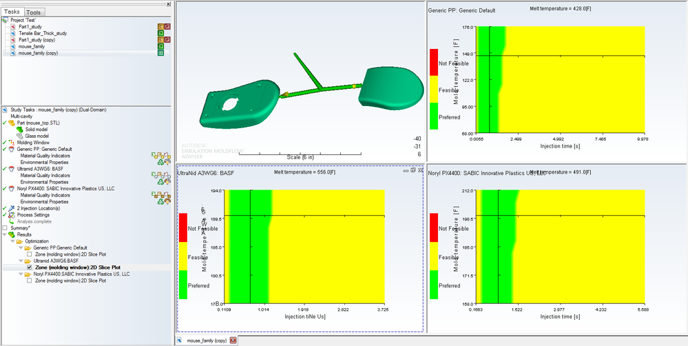

When running a molding window analysis to compare multiple materials is there a way to show all the results side by side without switching views?  Can the axis for each graph also be forced to have the same start and end points so each graph is similar to one another?

Hi Bob,
To view multiple results of the same study, I'd suggest using the "Split" option. Here, you can split the screen into 2 or 4 windows, of which you can choose a different result/view for each. To set which result shows in each window, select the desired window to activate it, then select the result to show.
In regards to your second question, the scales in this result are not able to be adjusted. The parameters can be adjusted when you first select the result, so you can select the same numbers there to get them to match more closely, however since you are comparing different materials, the timings may be different depending on the material properties. Additionally, the cutting plane for each can be adjusted by right clicking the result > properties.
I hope this helps!
