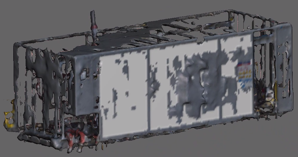

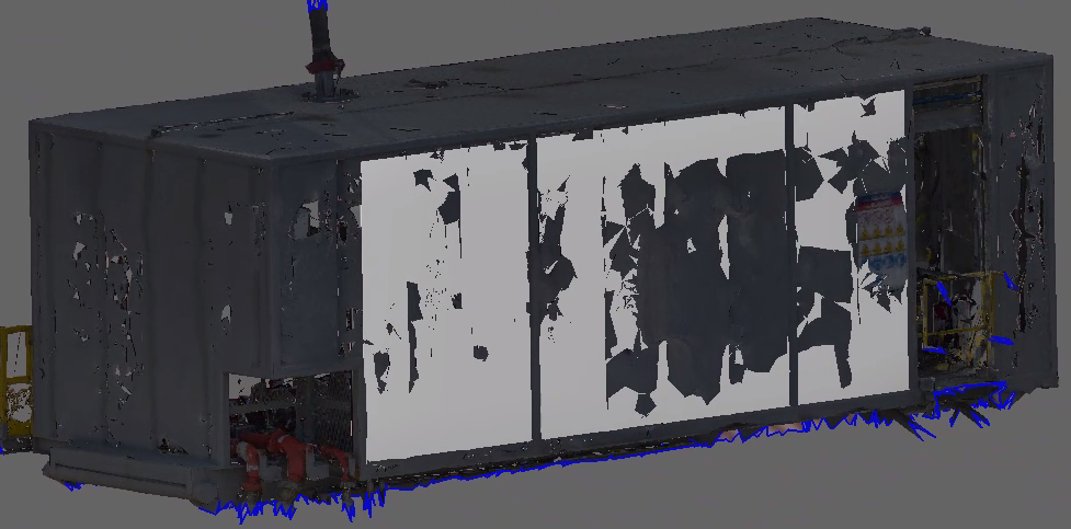

Hi there! New Meshmixer user here.
I'm trying to repair some 3D models and Meshmixer was recommended for ease of use and functionality. So far I'm liking it quite a bit; however, I did encounter a problem.
What I'm trying to do is cover some holes in my models generated elsewhere. It looks like this after import (.obj file):
As can be seen, there are lot's of holes in the sides of the container.
Next I add box primitive and size it to roughly cover the problematic wall:
Then select both objects in the Object Browser
Select "Combine"
I need it exported as a single mesh (rather than separate shells).
So next I select "Make Solid". And that's where the original portion of the model gets all messed up. Looks something like this:
Messing with the settings (like changing type to Accurate, increasing Solid Accuracy and Mesh Density, etc.) helps a bit, but overall the model still looks worse (more/bigger holes) than the original.
The answer might be in the settings, but I can't seem to find the right combination.
Any suggestions on dealing with this?
Any other way to fix those holes other than Draw a Box -> Combine -> Make Solid?
Thanks in advance for the help!

The metal sheets of the container are very thin compared to its overall size.
MakeSolid builds a virtual 3D grid. Each cubic cell of that grid hit by a single surface results in a vertex. Two surfaces (the front and the back of a sheet) inside a single cell are contrary data and therefor there will be no vertex.
You need to increase SolidAccuracy and MeshDensity so the resulting cell size is smaller than the sheet's thickness. You can set higher values than the sliders' ranges by a numerical input clicking on the displayed  numbers.
Basically your way to close the holes via an inserted object should work if the cells are small enough. But you loose texture that way (MM converts texture to PerVertexColor running MakeSolid.
A way to keep the texture is to isolate  inside and outside of the container.
Go to SELECT and select something (that's only a seed selection). Now run Modify/SelectVisible and hit Y to make the selection a separate object B. (Check if you selected and separated parts of the inside (looking through a hole. If yes select those regions, separate and combine them with the source mesh again) Repair interior open boundaries of this new object B using ANALYSIS/Inspector by clicking the blue marker spheres one by one until only outer open boundaries are left over. Now Combine again and run EDIT/CloseCracks to weld again.
Repeat this on another aspect of the container aso...
