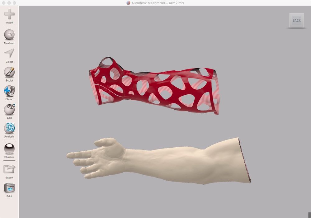

Hi all,
I have modelled a 3D splint which will be produced in 2 parts however it needs to be able to fix together over the arm.
 I would ideally like to have the cast printed in 2 parts (ie bottom and top), which will be fastened together at certain lengths depending on the total length of  the cast. On both the bottom and top parts, i would like them to join like a male and female electrical component ( like a plug with a socket ), or another example would be like 2 pieces of lego. I have attached an image of a previous design which utilizes this concept. If you look closely, one of the parts will have 3 or 4 "plugs" which go into the other parts holes or "socket". I like these designs because they allow the cast to remain smooth and prevent the catching of the cast with other things and are essentialy manipulatiing existing material to make a "mate" or "joint". https://www.xkelet.com/ also has a great design where the 2 pieces of the cast join like a plug and a plastic ring holds them together.
I have been shown that there is default connectors in meshmix, miscellaneous. However I would much prefer ones like in the photograph i have attached or the link. Could anyone suggest a way of modelling these or whether someone knows where i could find parts such as these? i have searched some websites for free .stl files but cannot find what i am looking for.
Ray

You mean the red base pattern above?
This was done on a Extraction of the dense source mesh (scan) by brush-SELECTion and SmoothBoundary:
Select the region to be supported by the cast:
Run Modify/SmoothBoundaries on this selection (Please note the tool settings in the following images):
Run Edit/Extract with Offset at zero:
Immediately after accepting the extraction hit Y to make the extraction a separate object. Hide the original scan object and SELECT one half of the cast using the selection brush:
Again run Modify/SmoothBoundary (Note: I enabled PreserveMeshBoundary to keep the outer seams of the cast).
Hit Y to separate the halves.
Enter SELECT again. Set a tiny brush size and double click at the blue boundary. This is a bit tricky. Maybe you want to zoom in. You should get only the boundary faces selected:
Hit Shift+. (dot key) to expand the selection until you've got a selection wide enough to be the outer frame of the cast's half.
Run Modify/SmoothBoundary on this:
Now use the selection brush at a proper size to paint the filling pattern (Remember: Holding down Shift while brushing subtracts selected faces):
Again run SmoothBoundaries. Here it may happen that the tool can't smooth some boundaries for the not selected islands own too few faces (such issues are shown in pale red) and you need to do some changes at your selection. If it works you should get orange regions with blue rings all over:
Accept the result, Hit I to invert the selection and X to discard the islands:Ohne Titel 12.jpeg
Do the same with the second half. Finally activate both halves (Hold down SHIFT to activate a second object) and run Combine:Ohne Titel 13.jpeg
