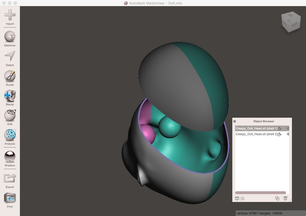

A bit of a Newbie to this so bear with me.  I have created a head in Meshmixer that I want to make hollow and have open eyes... ie: BJD type affair.   I have used the hollow function which appears to work ok.  I used a cylinder to place over the eye sockets and did a Boolean subtract which appears to cut the eyes out.  I tweaked the shaping a bit with the pinch tool.  I also want to slice through the top of the head to create a removable cap to access the inside of the head.   I played about with this but on printing  it printed a solid top once it got to the eyes sockets.
What would be the best way of achieving what I want to achieve?
Any help appreciated.  My printer is a Flashflorge Finder and I am currently using their slicer.

This is the kind of thing i need, attached.  I have sculpted the head and can hollow it.  I use a plane cut and separate shells for the head cap. How best to cut out the eyes? and set it up for printing ok ?

So you want to get eye cavities?
If so, don't do it on the hollowed model but before hollowing.
Drop a sphere from MESHMIX/Primitives to one eye as a separate object(CompositionMode = CreateNewObject):
Scale and move i using EDIT/Transform:
Activate the head object as the first object and holding down Shift click on the eyeball to be the second object.
Run EDIT/BooleanDifference:
Now you may refine the result using SCULPT brushes.
Run EDIT/Mirror:
Now run EDIT/Hollow and do the top PlaneCut:
Looking inside:

Thanks for that !  I learned some stuff from that 🙂   What i really needed was a hollow head with the eyes totally cut out.  I finally pulled it off last by trial and error.
I created the head and sculpted it.  When i hollowed it I just used the add hole function.  I moved them into place loosely got them to the size I needed.  A bit of sculpting to get them eye shaped.  Cut the top piece and this time it worked.  Before when I did this and got it looking ok.. when I went to print it it told me I had errors and when i went to fix it, it filled in all the holes that I really needed.
Not sure what I did but this time there were no errors to fix.  The new head was printed overnight and YAY its hollow with cut out eyes !!   Looks great.
