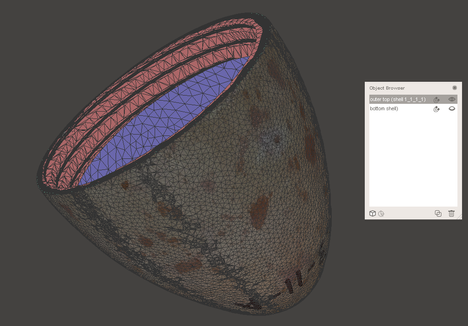

 So, you can't preserve UV mapping when making a solid in MeshMixer.
But now, color 3D printers are thing and I want to do more than have have colored faces, I want to print using UV maps.
Is there a workflow where I could make a watertight, hollow shell from two UV mapped OBJ files?
In other software I could...
Select only the visible external faces, invert my selection and delete, then close the boundaries.
Tell the computer to "clean up" all but the external faces.
I can't leave my model "as-is" because the printers can't make sense of it and try to wall off the opening.
Any ideas?And OBJ and an STL aligned. I want to print as a single pieceAnd OBJ and an STL aligned. I want to print as a single piece

3. Your special example(rather hard to guess from your screenshot):
MM offers SelectVisible (actually currently visible surface) in SELECT. You may sample up different aspects running the tool while keeping Shift pressed and discard it finally (hotkey "X")(maybe easier to try EDIT/GenerateFaceGroups and discard the outer group ). After getting rid of the redundant surface you might combine obj and stl to one object and fill the gab selecting the boundaries and Join (or Weld or Bridge) them....

Ooh.  Ooh. THANK YOU!!!!!!   THANK YOUOUOUOOUUUU!  This mostly works!!!!!
I've been messing with it for about 40 minutes following your suggestions and I see the direction your pointing me to.  Select visible is problematic since it's not possible to select under overhangs, or the back of the object.
Notes: Select visible replaces the previous selection UNLESS one holds  the "shift" key while entering the command.  The process requires that the shells are combined into one object, otherwise the software things I can "see" through the other shells.
Once the external geometry of the combined object is painstakingly selected, I can invert and delete the unselected internal geometry, but in the case of this model, where there are internal threads, it's not possible to select them all using the select visible.  I used a small sphere brush to select under the overhangs, but it requred repeated slection actions.  To select everything is roughly a 20 minute job, so i wish there was a "select most external triangles" function.
Then I can zipper the edges, and repair the holes from the tiny triangles missed during selection, which is ugly and slow.  This is a work around that is not functional for a daily workflow.
gryphern
To select the external faces of a combined set of UV mapped shells, then delete the internal triangles, then repair the problems caused by deletion, then weld the boundaries is at least 1 hour per model.  I can't finish it because the software crashes partway through the process repeatedly, but I think one hour or more.
There needs to be a way to autodetect then separate a single external shell in order to preserve UV mapping.

3. Your special example:
Your problems are not related to UVs in any concern. You should take a closer look at SELECT options to avoid errors you need to repair later on (and if you don't repair these errors properly risk crashes). Besides SelectVisible there are options as:
- A nice trick to check if you've missed some region is to run Modify/SmoothBoundary (but don't Accept). As it highlights selection boundaries you see what you've missed.
- There's ExpandRing and ContractRing. ExpandRing adds a loop of neighbour faces to the selection while Contract shrinks. Now you can get rid of tiny missed areas by growing the selection X-times and shrinking it X-times.
- There are RMB-drag Expand modes (requires Meshmixer navigation mode): GeodesicDistance  and CreaseAngle based (ColorSimilarity is based on PerVertexColor).
- Instead of discarding a selection the saver way if you are not sure to have selected all you want is to Separate the selection to a new object X. If there were missing regions go back to the source object, select the missing region and Separate it to an object Y. Now Combine X and Y and run EDIT/CloseCracks to weld.
- If there are watertight intersecting objects A and B. A is the active object. Now in SELECT double clicking at B selects all faces of A within B
- DoubleClicking a FaceGroup selects all faces of that group. You need to set GroupColor as MeshColorMode to see them.
Sharp edged objects (as your interior surface) are ideal for that. Run EDIT/GenerateFaceGroups and use its EdgeAngle Mode. Define the AngleThresh ( higher results in less groups) and SizeThresh (higher results in less groups) until you get a meaningful result. Now you have groups you can easily select.
Not knowing your partial shells:
Separate your two shells to two objects.
On the outer (textured?) egg surface select its outer surface, invert and discard its inside (if there's any). Close the open boundary using Inspector. This should result in something like a solid egg shaped half sphere.
From the inside object (use FaceGroups for that) select the groups pointing to the inside. Invert/Discard. SelectAll and FlipNormals. Close the upper hole and extrude this new surface a little bit . This should result in some negative part.
Activate the outer surface object first and (holding shift) add the inside object. Now run BooleanDifference.
This should be a 2min job you are familiar with the toolset.
