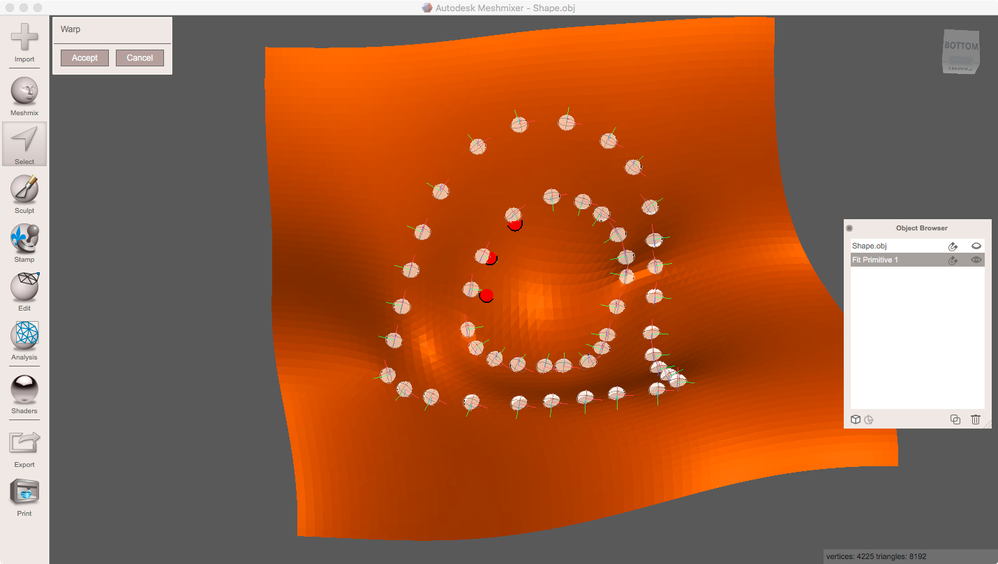

2. Design a parting surface:
From above you've got a face group. We want to use its boundary to deform a plane primitive:
For easier view drop the first shader from SHADERS onto your object.
Go to EDIT/CreatePivot. Set PlacementMode to SnapToGroupBorders. Double-click at the group boundary several times to get pivots at that boundary like this:
That done go to SELECT and double click the face group to select it. Run Edit/FitPrimitive. By default it will insert a square object. Set a high MeshDensity and make sure to check CreateNewObjects. Scale up the object using the transform widget. It needs to be about two times its fitting size:
Accept. Now there should be a FitPrimitive1 object in your scene. Leave SELECT and hide the shape object.
Activate the plane and select all of it (Ctrl+A). In SELECT go to Deform/Wrap.
In Wrap double click next to a pivot to create a red sphere. Drag this handle to the pivot to make it snap to it. Do the for all pivots to deform the plane:
After accepting Wrap yo should discard all pivots. You may make them visible in the ObjectBrowser clicking the pivot icon in the bottom-left of the browser. You may now show the source shape to check the parting surface:

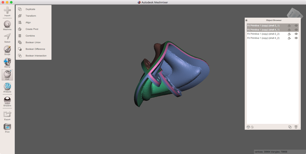

If the molds' sizes are bigger than your printer's volume it's to to cut the halves. To do this EDIT/Combine both halves to one object for now and run EDIT/PlaneCut at Slice(KeepBoth):
Run EDIT/SeparateShells to split all of the mold's parts again.
On each of such parts run EDIT/Hollow to define the wall thickness of the final print:
(Note: in the above image MM create two empty shells- I discarded them - ignore them)

Run EDIT/SeparateShells on the two halves , activate two parts constructing the curved flange and Combine. The same for the other pair:
