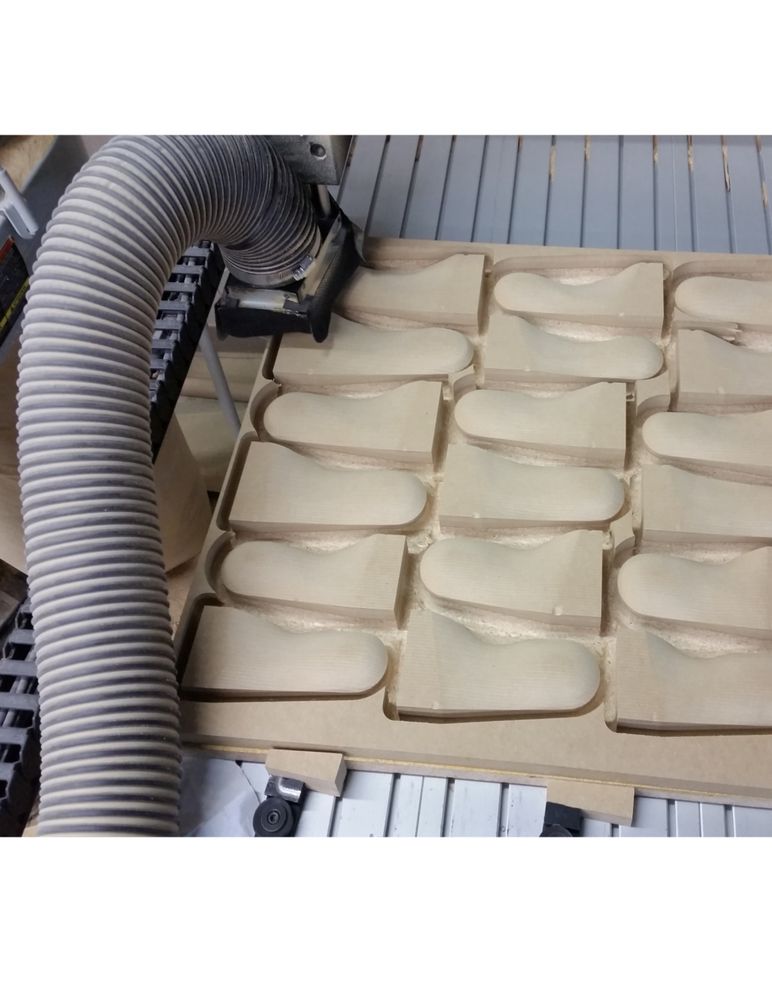

I'm looking for help with my CAM process.  So anyone daring enough to assist, grab a coffee and settle down as this is a long read, I figured I might as well give all possible info at once instead of 20 messages back and forth.
My name is Andrew I make custom made foots orthotics. A few months ago we purchased BobCAM but are very unhappy as it is not doing what we need and they have said the program in unable to accomplish what we need, so I am in the market for a new one. I'm trialing Fusion360 but it is  complicated!
I am a medical clinician and not at all a machinist.
Our orthotic manufacturing process is:
  1. Take a 3D scan of each patient's foot (We use the Occipital Structure Sensor)
  2. Reshape, modifiy and correct the .stl of the feet. (This is our CAD, we use Meshmixer: https://www.youtube.com/watch?v=rVXdSo2i0wQ)
  3. Import 3-4 different .stl's of pairs of patients feet, into CAM software, arrange/nest within the stock. Create a toothpath and a labelled reference map/image etc to help quickly identified who's foot is who, as to not mix up these custom orders
  4. Using our Techno CNC LC Series 3024, we mill the custom 'positives' of patient's feet out of polystyrene foam. (End product looks like this)
  5. Remove the positives from the stock, vacuum press a hot sheet of polypropylene on top to make the orthotic shell
  6. Cut off the excess plastic by hand and put a liner on top
We purchased BobCAD V31 as our 3 axis CNC CAM solution to replace our current old (but quick & automated) DOS CAM program we have, because this old one is incompatible with .stl files.
For CAM we were just going to use the free version of deskproto as the replacement, but it was missing two main features which made investing in a paid program worthwhile for us. (BobCAM said it had these features but it definitely does not.)
These two features required in our CAM solution are:
  1. The ability to quickly click and drag geometries to manually 3D nest 3-4 sets of the .stl custom foot geometries in the stock (or automatic nesting would be ideal, but more on that later). We ideally want to only spend about 2 minutes to load the 3-4 geometries and slide them within the stock.
  2. The ability to automatically (or at least quickly/easily) track/map and then print a page of a labelled image/map of the stock of which customer's foot ended up where within the stock. (again you can see how it could be confusing tracking the orders in this, so a printed labelled map layout of the stock arrangement is needed).
To note, toolpathing customization was of no concern because polystyrene can be done in a single pass if needed, nothing fancy is required.

Well, one can do nesting in MM:
Create a "printer" in size of your stock (> Preferences/Printers > Add) and set View/ShowPrinterBed and select your "printer"(= your stock) in the upper-righthand dropdown list.
Separate all your pairs.
Now do ANALYSIS/LayoutPacking which gives several options (rotated or lined up, distance between aso).
The labelling is harder. Do you need a string like a customer's name or only some marker allowing to find the pairs after milling? Think it's doable to create a mmapi script reading the file name and either based on a SCULPT tool with a "name-stencil-image" or an auto-generated MESHMIX part dropped onto both soles. But that would need some coding...

OMG how did I not see that packing/layout feature! I'm been trying to figure out for days how to do this. It works perfectly! I am so happy and embarrassed at the same time! You are like a wizard on and all over this forum, you have the answer for everything! Thank you so much! (Also I noticed a small insignificant menu error, once you select the packing icon, the menu that pops out has the  'overhang' icon displayed rather than the 'packing' one.)
I am consistently impressed with MM, I was looking into buying a $10K insole CAM program that specialized in having this feature and here is MM doing it quicker and for free!
Now as for the labeling issue yes I would like to see each customer's name floating over top of the mesh, or imprinted directly on the mesh, and done so as automatically as possible. I am currently labeling manually by taking a screen cap and labeling over it in MS paint (see attached.) However this has lead to human errors in the labeling task.
Also need to make sure and label added in MM does not get milled out by the CNC. This label could be automatically 'pulled' from the file name. I typically leave each pair of feet beside each other a set, so I don't need to separate the shells as you did in your example, however that would certainly make for even more efficient stock use if I want to try to squeeze in an extra pair per stock.
Now I do not know near enough about mmapi scripts or C++ or coding for that matter. This is getting more than a bit out of my league. Google lead me to this:  https://github.com/meshmixer/mm-api. But it appears to not be functional for MM3.5, and there has not been any updates for a few years. However the main contributor from that link is Ryan Schmidt who I believe started MM.

Yep, you found the right source. This API still supports MM3.5. and since no major functionality was added since Ryan (RMS) left Autodesk it still gives access to almost all functionalities and their parameters. This is pretty awesome  and powerful to automate fixed workflows.
I don't use it via C++ but via Python to add custom features.
If I got you right you don't want to get the labels being engraved in the milling result but only some kind of 2D plan as a printout? Doing the screenshot at a certain cam position (here view from top) via API isn't a problem and reading the filenames from the objects list is easy. One can also find the 3D position of an object. So the only thing to solve is how to edit the screenshot image to set a label overlay at a certain 2D position. Think this is doable using Python's PIL module but new to me. Maybe I find time to look into that ( I can't promise when this will happen but this is interesting for my own projects as well)...

You are incredible! Yes just an image of the filename that appears over top (at geometry centre perhaps) so I can take a screen shot. Exactly how it looks in my previous posts's attached image [Layout - CAD (with labels).png]. Or kind of like how when you go to 'Units/Dimensions' the XYZ dimension labels will appear.
Now how does the API work, it is a separate thing that you have to start up and run alongside MM, or do you basically install it into MM, can it directly change the MM buttons and menus?
Because ideally I imagine the script would be able to create an additional option in the Meshmixer 'View' drop down menu that makes the object name/label appear over top of the foot (at geometry centre), and of course ability to unselect it to make the label disappear. It could be called "Show Object Name". Just like "Show Boundaries/Wireframe/Grid" etc.
We can still just hit the print screen button on the keyboard and then paste into MS Paint and then print the page. However if you are also able to figure out a way to automate this portion as well to save that precious 30 seconds every time, I would not object.
Thank you so much! Is there any way I can help you? Roughly what time frame are we looking at, if you were to work on this problem. Maybe a few more weeks, a few more months? Thanks again!

Unfortunately there's no way to run scripts as a plugin inside MM.
So it's basically some remote control application from outside.
This allows to add coding stuff from other Python libraries (e.g the mentioned PIL which is an image processing lib).
There are two ways to use such code:
A: You can execute the code via Python IDLE (the code editor)
B: You can compile the code to a standalone application (as a command-line tool or as a GUI application)
It should work to add small plane objects and add the text as a texture to that planes.
Here I tried something different:
The code moves the cam to top view and adds a plane square to the scene. In MM RecenterView fits an object so it fills the height of the current window size about 70%. I use this to get the plane upscaled to 70% of the printer's base size, selectAll of it and do RecenterView on that selection. Now the printer fits to the view.
From this view I grab a raw screenshot. Comparing the screenshot dimensions with the known size of the printer I get a scale ratio. This ratio can be used to convert the different object positions (out of MM) to positions on the image. Now I add the object names (out of MM) and write them as text elements on the image.
The defaults are set at 304.8 x 609.6 if you need a different size define it via EditStock.
