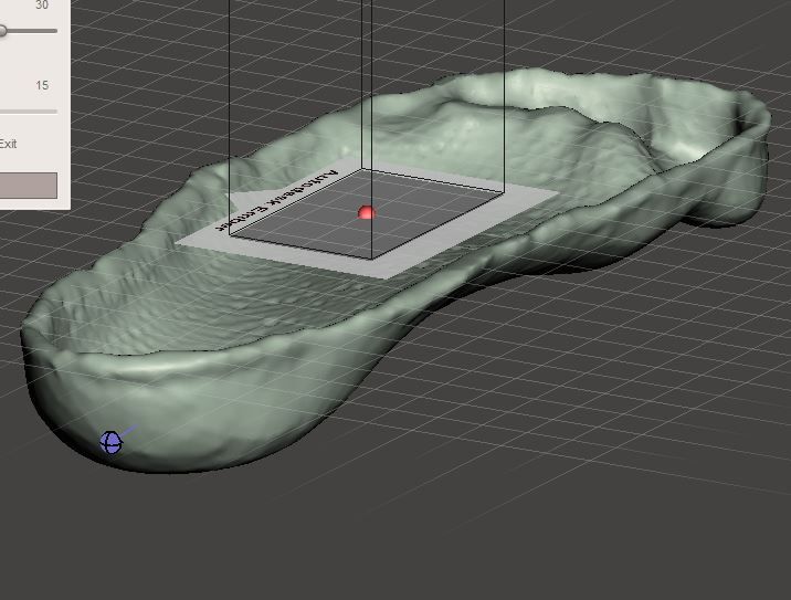

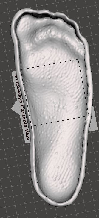

Hi all,
This is my first Autocad post so please be patient.
I have used Autocad MeshMixer and Sculptris to generate a 3D CAD .OBJ file of a scaled 3D orthotic insole. The insole is nearly complete I only need to create small indents on the top surface to help the feet to breathe. I did manage to do a dual edge pattern with 5mm element spacing and 5mm element sizing which gave the above JPEG images of the insole. I only want that type of pattern on the topside nowhere else. Can I please have help with doing this in MeshMixer? Thanks

Message 21 of 34
I have done this thanks.
  • The files are now almost ready to be 3D printed. I have checked the Inspector, Units/Dimensions, Mesh Query, but the Thickness check is producing blue sphere pointers, are these thin areas? Also for the Overhang check I think the default overhang support is fine - is there a standard overhang setup to put down? Thanks

Message 22 of 34
Yep, the blue markers in Thickness point to regions thinner than the MinThickness value.
Two things to consider:
- a minimal thickness you want to make sure for your product (to get a certain strength of material)
- a minimal thickness your printer can handle. If the thickness of your object is smaller than the nozzles diameter (FDM) or the resolution of the projection (e.g. DLP) > this might end up in holes in your print.
Based on the way MM searches for thin regions (more info at MMHelp on Thickness😞 Don't worry that much about "thin" regions where the surface turns harsh from a inside to outside (as in your last image). A real thin region is where the makers point to a wall (as in your first image).
You can thicken such a region:
A. By clicking on its marker > You'll switch to SELECT with the thin region selected. Use Edit/Offset (with some SoftTransition bigger than zero) to thicken the region.
or
B. By running EDIT/MakeSolid in SolidType=Accurate. There you have the option to set a MinThickness all over ( if you joined the pattern and the source via MakeSolid (as explained above) you could do this in that step as well)
The right overhangs angle depends much on your printer technology, the used material and the printer settings you actually use for the print... maybe DLP/SLA printers need supports up to 45° while FDM printers work in a range of 25°-45°... consider things like the diameter of the nozzle, cooling issues...
Actually you need some test prints to get an idea what a printer can handle.
Message 23 of 34
I have removed any blue spheres (thickness errors) and added support below with a 25 degree support in place. I am now looking to print 1 of each of the insoles (with support) using a PPV material on a cheap 3D printer. Please can you let me know a cheap 3D printer that uses PPV? I am not familiar with 3D printers. Thanks

Sorry, can't give some advice on printers working with PPV (which seems to be a very special polymere)...
As you can see in the images you posted: MM only creates supports inside the printer's build volume. So you need to setup a printer big enough to include your object totally first to get supports where needed all over in Overhangs.

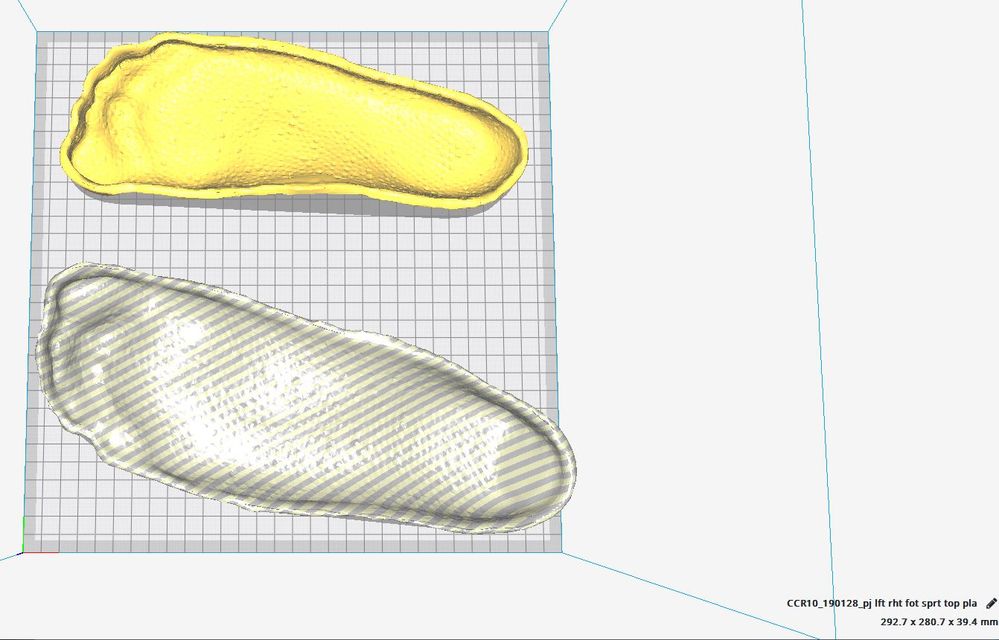

Message 27 of 34
I am going to use Ultimaker Cura 3.6. As splitting each orthotic into a top and bottom layer is dependent upon the available material, which in itself depends on the 3D printer, I would rather use Cura (if possible) to set up face groups to print the orthotic rather than MeshMixer. Available single (top and bottom) materials are ABS, TPU, PP and various others. There are also various combinations of top and bottom materials. Is there a way to use Cura to set up Face groups? I have taken an image below showing each of the 3D orthotics within Cura using a Creality CR10 printer with TPU material selected. ThanksRight foot Creality Cr10 TPU materialRight foot Creality Cr10 TPU materialLeft foot Creality Cr10 TPU materialLeft foot Creality Cr10 TPU materialto generate a face group within
Message 28 of 34
The upper workflow results in two objects. Export both. Import one, print it in the desired material. Import the other and print it in the other material. Glue both prints together...
If you've a dual material extruder import both in Cura and align them. Here's how to do that in Cura
Can't see why you want to get the groups into Cura and I don't think Cura supports groups.
Message 29 of 34
I have created 3 Cura files with 1) 5mm 1 material orthotic thick TPU material for both left and right, and 2.1) and 2.2) 1mm thick ABS (hard) bottom and 4mm thick PLA (soft) thick top 2 material orthotic as below. I have ensured that the space between the orthotics on the heat tray is maximum, the minimum distance is 10mm. Is there anything else I need to do before ordering the 3D printer in terms of modelling changes? Thanks
1) 5mm left & foot right TPU material1) 5mm left & foot right TPU material2.1) 5mm left & foot right foot bottom shell PLA material2.1) 5mm left & foot right foot bottom shell PLA material2.2) 5mm left & foot right foot shell top PLA material2.2) 5mm left & foot right foot shell top PLA material
Message 30 of 34
Are you sure about the scales? Seems the soft parts look too small - but that might be just an optical illusion.
On a single nozzle extruder I would do the print in four separate jobs:
- print hard ABS: right insole
- print hard ABS: left insole
- print soft PLA: right insole
- print soft PLA: left insole
>>> less risk if a print fails plus no travels between objects. Production time should be nearly the same as if you print both soft and hard jobs at the same time.
On a dual nozzle extruder you have to align the soft and hard shells (see link above)
Overall seems you're done with modelling.
