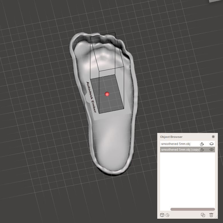

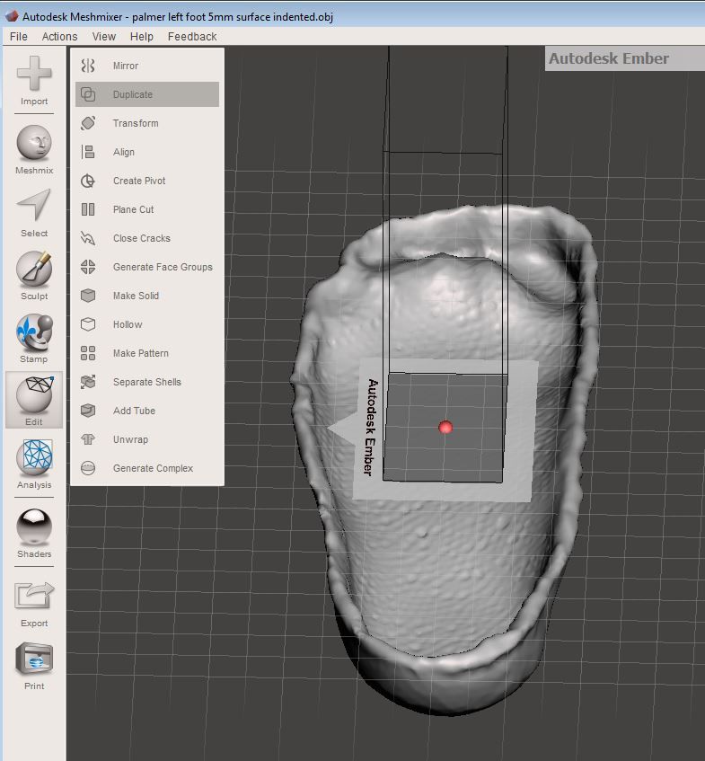

Hi all,
This is my first Autocad post so please be patient.
I have used Autocad MeshMixer and Sculptris to generate a 3D CAD .OBJ file of a scaled 3D orthotic insole. The insole is nearly complete I only need to create small indents on the top surface to help the feet to breathe. I did manage to do a dual edge pattern with 5mm element spacing and 5mm element sizing which gave the above JPEG images of the insole. I only want that type of pattern on the topside nowhere else. Can I please have help with doing this in MeshMixer? Thanks

Message 2 of 34
Two things before:
  • You can hide/show the rendering of the printer via menu: View/ShowPrinterBed
  • Think there's nothing in Sculptris what you can't do in Meshmixer's SCULPT
MakePattern is a tool always affecting the total object. So you'll need to create a separate partial object from the source object, make the pattern based on this and join this result with the source object doing a boolean operation finally.
E.g.:

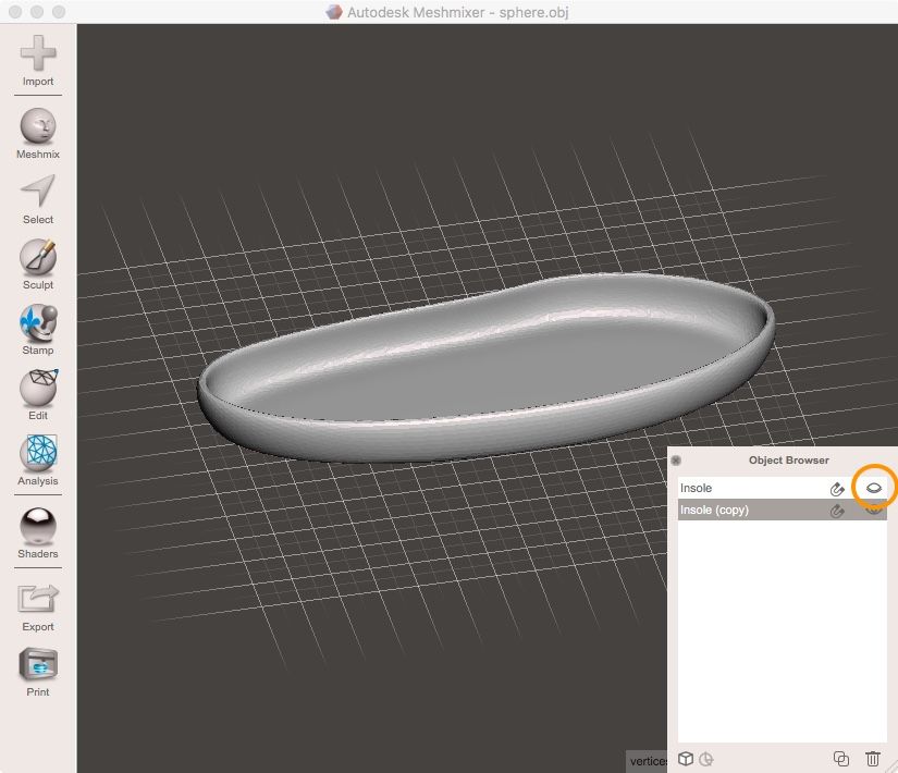

- Make a duplicate of your source mesh (EDIT/Duplicate) and hide the source (via ObjectBrowser clicking the eye icon):
- on the duplicate run EDIT/PlaneCut in CutType=SliceGroups and and cut off the upper "slice":
This splits the object to groups:
Go to SELECT and double click at the inside green group:
Hit I on your keyboard to invert the selection and hit X to discard the selected surfaces:
Now run EDIT/MakePattern on this:
Accept:
Show your source object again (again via eye icon)
With Shift pressed click on the source to activate the  insole as a second object:
Now there's BooleanUnion in EDIT. Run it:
And finally Accept.
Note: MakePattern (doing this workflow as well as your upper global attempt) results in an offset of half the ElementDiameter. Think you'll need to include this behaviour while constructing the source mesh to give a perfect fit finally.

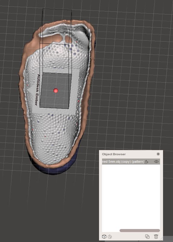

I did the following steps:
1. Make a duplicate of your source mesh (EDIT/Duplicate) and hide the source (via ObjectBrowser clicking the eye icon):
step 1step 1
Completed step 1.
2. on the duplicate run EDIT/PlaneCut in CutType=SliceGroups and and cut off the upper "slice"
step 2step 2
I click Accept then get the below
step 2_1step 2_1
the step 'This splits the object to groups' isn't achieved because I can't see the place cut and nothing is automatically highlighted as the green surface was in yours. How do I get the place cut to actually show and be displayed? And when I try to go to the next step after 'Go to SELECT and double click at the inside green group' I get the below images
step 3_0step 3_0
and, when I go to SELECT and double click, the whole of the second object is selectedstep 3_1step 3_1
Where am I going wrong?

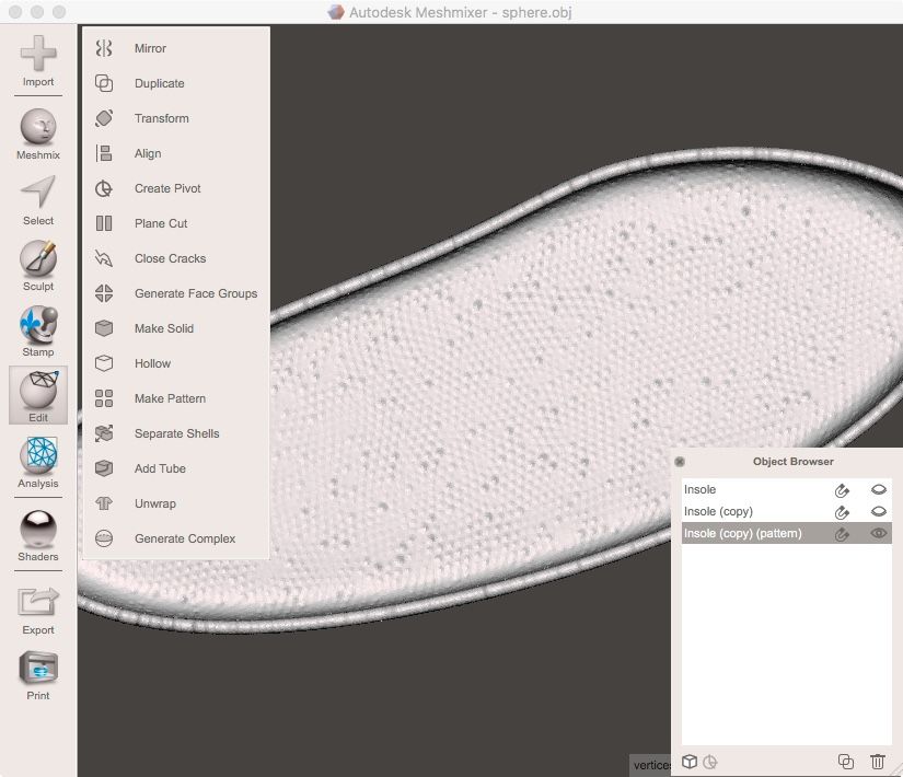

Hi there,
I got down to Step 20. Combine/Boolean. Boolean didn't work, error message. I tried to do Combine got below 2 of 3 images. Resulted in the Inspector filling in the deliberately made indent holes. How do I combine the 2 objects (indented surface and original) without having to fill in the suface again? Thanks
Combine_boolean didn't workCombine_boolean didn't workInspectorInspectorInspector result-flat fillInspector result-flat fill
Message 18 of 34
Not sure about what causes these Inspector infills. Maybe you didn't check Connected at the Offset step? Please note the tool settings in the images of the different steps...

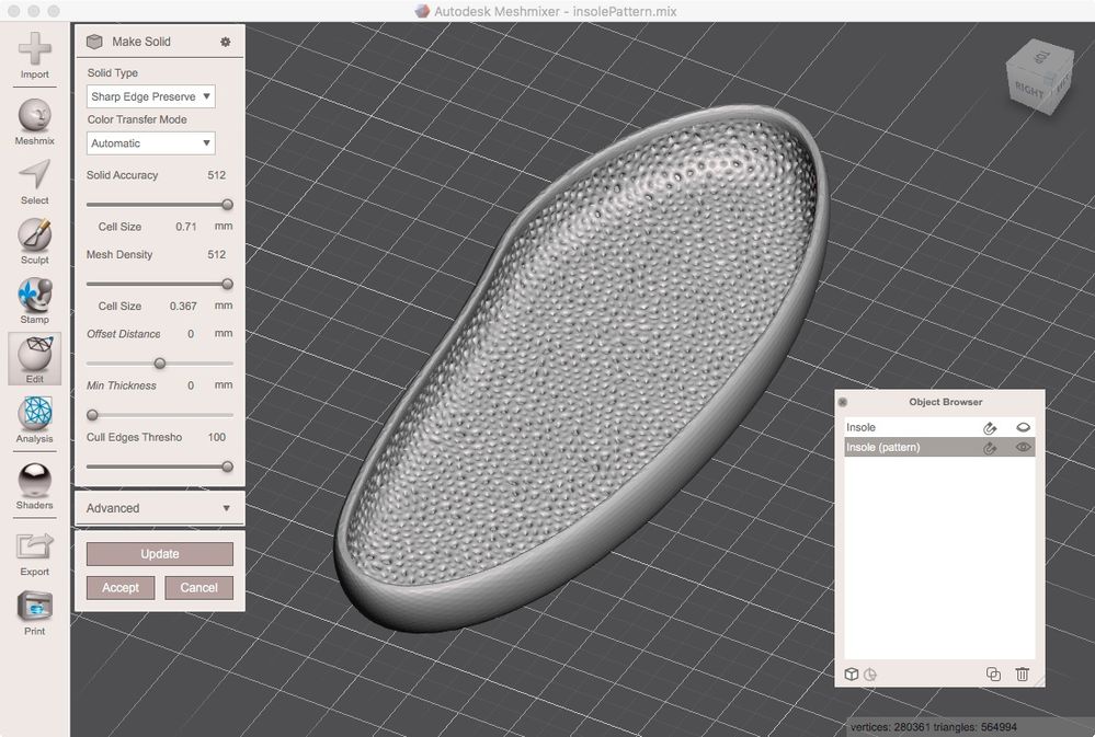

As an alternative to a Boolean Union:
1. Combine both objects (pattern and source) to one. It's not enough to activate both. You need to run Combine when both are activated instead of BooleanUnion.
2. Now at the resulting object run EDIT/MakeSolid at a high SolidAccuracy and MeshDensity:
Message 19 of 34

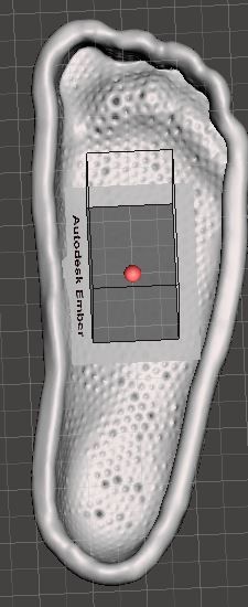

I've done the left foot.
left foot doneleft foot done

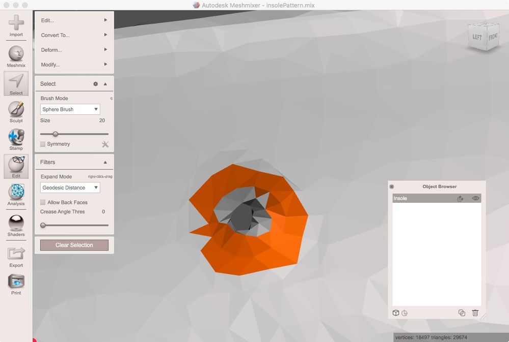

the right foot, due to a partial hole on the original OBJ was only able to have the pattern applied 10mm from the top.red arrow partial holered arrow partial hole
Please let me know how I can close this hole so that the final right foot OBJ has the pattern applied 3mm from the top? Thanks
Message 20 of 34
Seems to be a hole connecting the inside and outside surface like (cut through to visualise):
To fill such a hole you need to select a ring around that hole:
Do such a selection on the inside and the outside and hit X to discard it.
Now go to ANALYSIS/Inspector. Think in your case you should set HoleFillMode to SmoothFill. Inspector should detect two blue issues (open boundaries) and maybe a pink small mesh snippet (the former connection):
You can do AutoRepairAll to get rid of the hole now:
