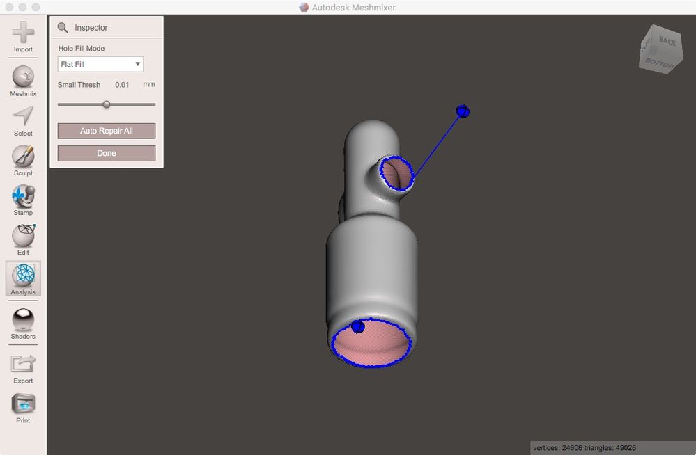

Thanks for the response, I am learning a lot. Inserted below is a screen shot of my results. The problem I see is I first have to close all bores and opening to the inside of my model so I get a solid negative of my part in the mold.
I have tried extruding surfaces to close the gaps, but it got really messy and I think it affected my first attempt. is there a better way to make my model completely solid?
Message 4 of 17
I see...
You need to break the connection of inside and outside stuff and fill the holes:
Go to SELECT and set a small brush Size.
Paint a closed ring selection around each hole. Try to select nothing but planar regions:
Hit X to discard these faces. Now the outside shell isn't connected to the interior any more.
Select something at the interior shells and hit X to expand the selection to connected triangles:
Hit X to discard those faces and go to ANALYSIS/Inspector to close the open boundaries:
After hitting Accept you end up with a watertight surface.

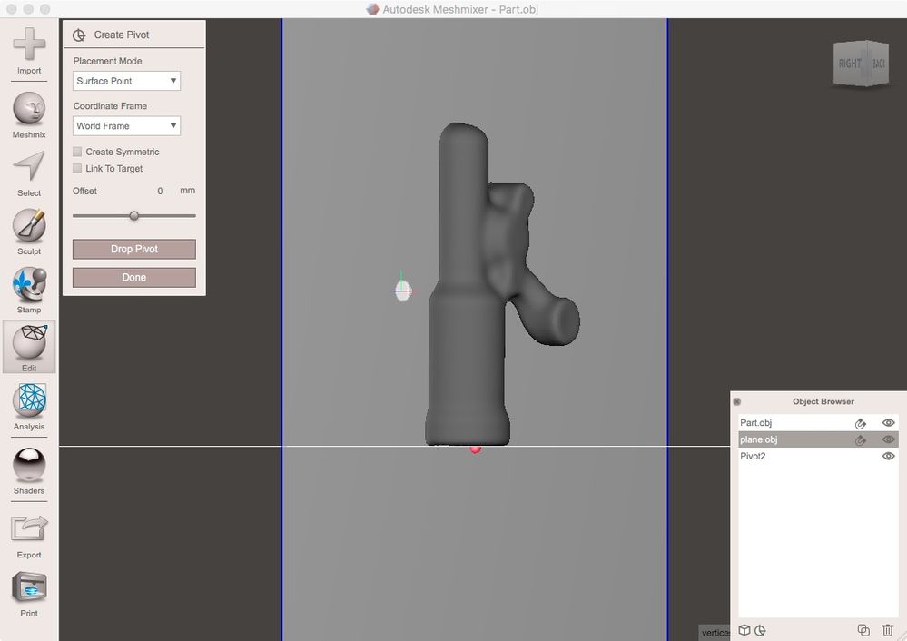

Now before deleting the plane we want to save its position dropping a pivot on it:Ohne Titel 9.jpeg
A pivot can be activated and transformed as any object. To show pivots in the object browser click the pivot icon in the lower left of the browser next to the cube icon. Delete the plane , activate the pivot and run EDIT/Transform.
Make sure that the widget shows the A,S and W circles in green. In this Absolute Snapping in World coordinates mode the values TranslateX, TranslateY, TranslateZ show its current position. Let's set all those values to zero  (clicking on the numbers in the tool fly-out) and hit D to drop a duplicate there. Now input the lower Y distance of the lower locator in TranslateY, hit Enter and D to drop a duplicate on this position:Ohne Titel 10.jpeg
Continue to put in the needed Y values each time creating a duplicate. When done in Y put in the width of the locators  in X. You should end up like:
Ohne Titel 11.jpegNow we have accurate fix points

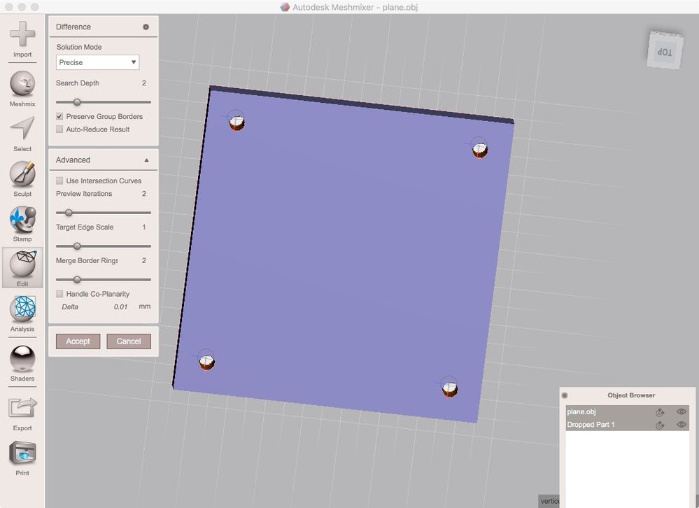

Virtual drilling is easy:
Let's assume a cubic object. Its length and width is 200mm (for easier calculation). Use EDIT/Align with Source=BasePoint and Destination=WorldOrigin/Y-Up to align its base to the origin. Now its base corner coordinates are at A = (X=100, Z=100), B =(X=100, Z=-100), C = (X=-100, Z=-100), D = (X=-100, Z=100), right?
Now we want to drill 4 holes with their centers in a distance of 20 to the edge.
Drop a pivot somewhere at the base plane ( or the upper plane) and run EDIT/Transform on it:
In the tool flyout set TranslateX = 80 and TranslateZ = 80. Hit D to drop a pivot thereOhne Titel 2.jpeg
Now set these parameter to -80,80 and hit D > set them to -80,-80 and hit D > set them to 80, -80 and Accept finally:
Now MESHMIX solid parts snap to pivots if you drag them near to a pivot. So drop a MESHMIX/Primitives cylinder onto the object, set the desired hole diameter at Dimension and drag it near a pivot until it snaps to it. Hit D to drop a duplicate there
(Note: Duplicates are not visible in DropSolid until you click Accept finally but they appear in the object browser). Drag it to the next pivot and hit D, drag it to the next pivot and hit D , drag it to the last pivot and hit Accept.
Activate all those cylinders and run EDIT/Combine.
Run EDIT/Transform and scale/move them in Y (green) until they reach through the cubic object.
Now activate the cubic as the first object and the cylinders as the second one and run BooleanDifference. (Don't forget to disable AutoReduceResult at low poly objects):
