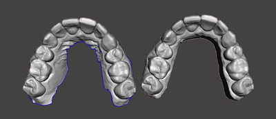

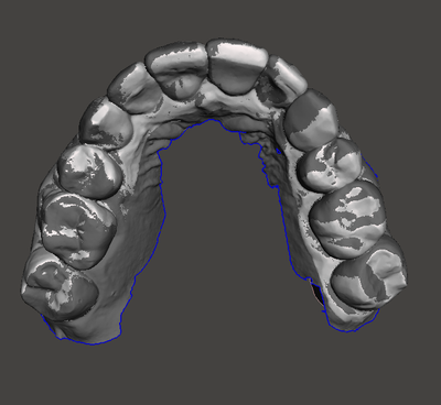

How do I align/overlay these two dental arches? I have a dentist that is saying the teeth have moved and would like to compare the two different scans. the first screenshot is of them separated and the second is me doing my best to align the two scans. Is there a way to do this more quickly and easily?

hfcandrew
Read:
https://help.autodesk.com/view/MSHMXR/2019/ENU/?guid=GUID-6AD70EE2-6EE4-4676-A35B-851894924FCE
Set one object as your target by pressing the '~' key > Select all on the other object > Edit > Align to target.
paulHNAV3
@hfcandrew I don't see align to target as an option.
