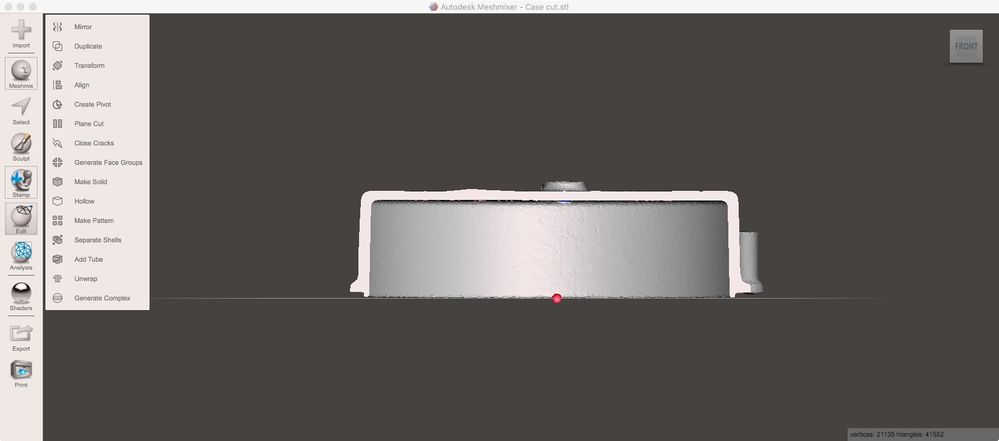

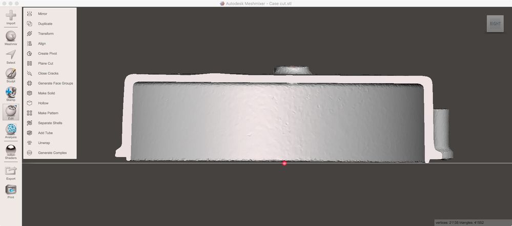

- Your source mesh isn't aligned properly to the world planes. Alignig its bounding box to the origin gives that result:Ohne Titel.jpeg
Note the slight lefthand offset.
Think the top surface should be parallel to the grid. So do EDIT align with Source at SurfaceScribble and Destination at WorldOriginYUp. SurfaceScribble allows to draw a loop on a surface. The averaged normal of the included area will be used for alignment. So scribble a loop on the transparent ghost where you consider the object to be planar. (Sorry can't capture the scribble line in a screenshot):
Now after rotating 180° and moving the base to the height of the grid, things look better:

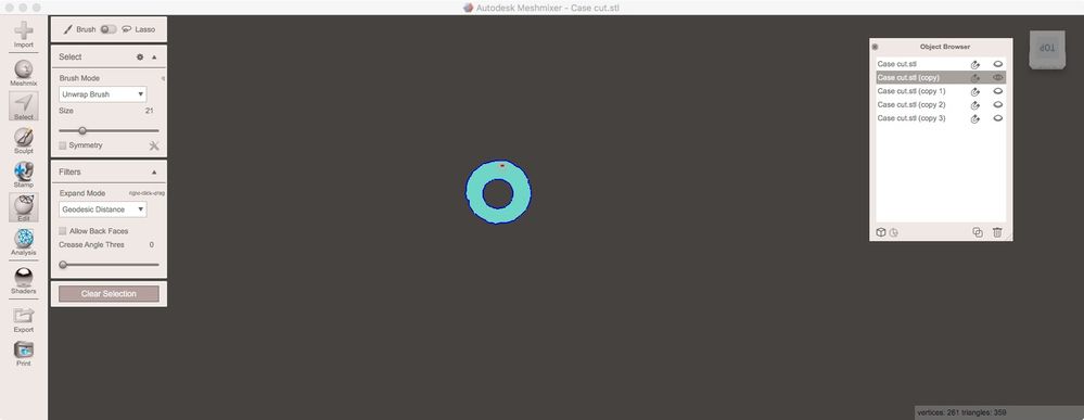

You might trust ANALYSIS/Inspector to close these open boundaries but IMO you'll get better results capping the holes. Draw a closed selection loop around each hole
and discard:
After you did that on each hole select a seed selection on the main surface, hit E to expand to connected, then invert hitting I and discard (X).
This result run in ANALYSIS/Inspector to close all holes in a flat way.

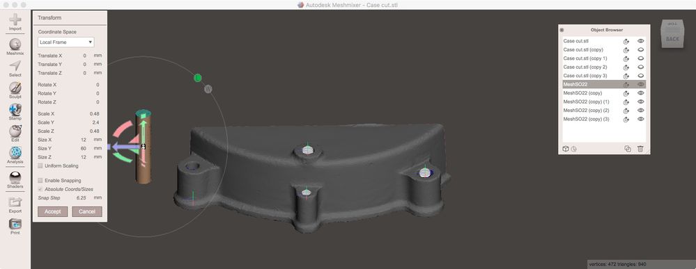

Ohne Titel.jpegAnyway... having a watertight source object:
Drop a MESHMIX/Primitives cylinder to empty space. Scale its dimensions to be the drill and generate as many holes to drill (the following screenshots are based on an Inspector Autorepair):
EDIT/Align each cylinder to a pivot ( Source=CenterPoint, Destination=Pivot)
You might need to scale the cylinders in Y to give them the needed length:
Now activate all cylinders and combine them to a single object.
Activate the source mesh and the cylinders as a second object (LMB+Shift) and run EDIT/BooleanDifference:
