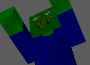

Hi, I am new to Maya and have recently been getting started on texturing objects with files. I have finally had the time to finish my first project which was to texture a very basic zombie. However, now that I am done, there is a problem with the zombies torso part. At certain angles the arms and the le head render themselves in front of the zombie torso and I am not sure why. I have even tried to make a completely new torso and texture to fix the problem but the same thing occurs. This makes me think that it has something to do with the object's position but I do not know what would cause  this. Here are some images showing the problem.
But sometimes when I am close to parallel to these objects some render in front of the other.
At this angle both the head and the arm render in front.
Thank you guys for helping in advance!

Hi!
Make sure the transparency attributes of your materials have a value of exact 0, or set Transparency Algorithm in Viewport 2.0 / Hardware Render 2.0 Settings to "Depth Peeling".
Could it be that your texture is also in your transparency slot, I have had this problem a few times.
Simply right click on Transparency and select Break Connection.
Thanks for your responses guys. Apparently I had the Viewport 2.0 on object sorting and changing it to depth peeling sorted out my problem just fine. My zombie looks great now. 🙂
