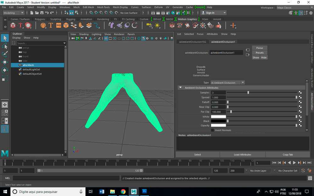

Message 6 of 8
It's not the scene I'm working on, but even with a simple AO does not work, step by step I follow:
