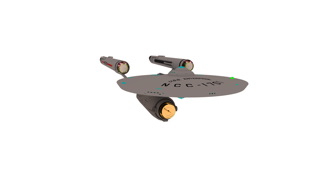

Hey guys,
I have a strange issue, where I can see the movie texture in the viewport, but when I go to render the current frame, then the polygon shows up as the default grey color - see attached images
As you can see, the "vortex" movie appears on the engines in the viewport, but not in the render.
Also, when I play the animation, the movie does not update in the viewport. The vortex movie is a movie of a vortext actually moving. Yet, in the viewport, it is only showing the first frame.

Are you using a .mpeg or something?
Try to use an image sequence.

tam2000k2
Thank you for replying. I have tried both mov and avi files. I finally used a sequence of jpeg to make it work
I followed the following YT tutorial - https://www.youtube.com/watch?v=ZQw380ff6SQ&t=190s

Just in case anyone experiencing this issue, the following is how I solved my situation.
First, I was using a model that I downloaded from a website.
I was trying to apply a .mov or .avi to the sphere shaped object that appeared to be a polygon.
As you can see by the post above, I ended up using a sequence of jpeg files, but it continued to bother me that I was unable to use the .mov or .avi file. That is when I thought that the issue maybe with the object that I was applying the .mov or .avi file, which turned out to the be the case.
I created my own sphere, using the sphere under the polygon tab, followed by making it look like it was a glass texture, then I created a disc and applied the .mov file, which worked as expected, followed by placing the disc within the sphere object. I did not do as well of a job on the glass sphere, but that is ok for now.
The initial issue has been resolved. The following image is a screenshot of one of the six hundred rendered images
The upper port light still flickers, rather than have a smooth on and off sequence, but that is another issue. The final render can be seen on YT - https://www.youtube.com/watch?v=LQ7uV--gELw
