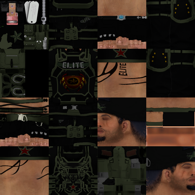

This is the body color map, the alpha map from it, the body normals, and the normal's alpha map. The dog tags, which can be located on the top left corner of the maps, are 100% black. In order to have the transparency on the model (for stuff like the dog tags), I use the body normal map's alpha.
It seems that the game uses a series of ramp nodes on the alpha to get different values of specularity depending on what kind of clothing the character is wearing. And yes, I am currently using the body color's alpha channel on the specular color channel and this is the result I am getting when setting specific ramp settings.
