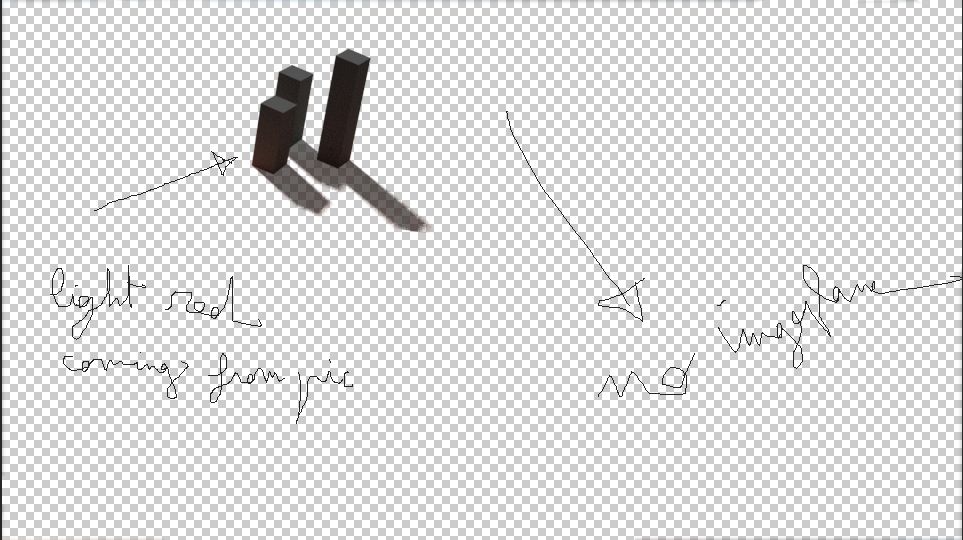

I m working on an incrustation, with an image plane and aiShadowmat.
for comp purpose I want to render only my geos/shadows and no background (i do want the influence of the image plane on my geos though)
when i render in software using *.png  the shadowMatt is alpha-transparent witch is almost cool for comp( -pic 01)forum1.jpg
However when i batch render with same layers and settings  aiShadowmatt will just catch shadows and display the imagePlane (pic 2 ) not cool:
if I render with a clone camera, i lose the nice indirect color influence of the image on my geos, so :
How could i Batchrender as in picture one with shadowmatt being alpha?
or even better :
How could i batch render with the color influence of the imageplane on my Geos, but with no image plane at all? as in pic below :
Hope you understand my question, sorry for my poor English.
