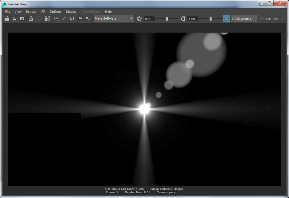

Hi, does Arnold renderer support lens flare and light glow like this?
I tried many renderers but it seems that only Maya Software renderer works. So I was wondering if Arnold does not support lens flare and light glow at all, or I missed any configurations of Arnold renderer towards this light effect. Thank you for any help in this regard.

Arnold does not support lens flare and light glow, but "Bloom" is now available in Arnold, which is a kind of glow.
