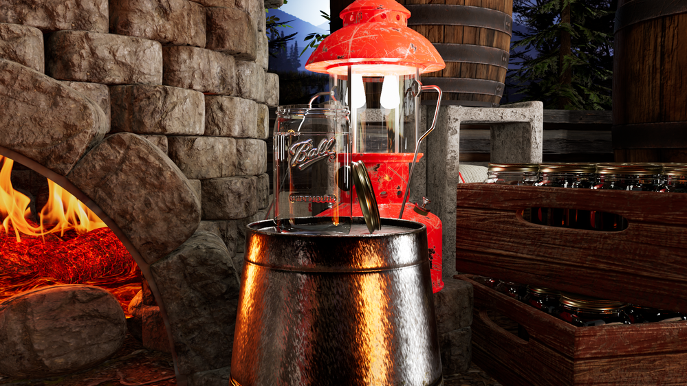

I added Maya to the high performance graphics list via the NVIDA control panel. I'm not sure how else to specify what Maya uses. I've also noticed my renders are taking waaaaay longer than they should be for this processor. Not sure if the 2 issues are related. I mean waaaaayyyy longer. I just rendering something I don't feel should have taken more than a couple hours... took over 16 hours! I've never experienced that kind of render time in the work I do. I've bumped up the settings from default, but nothing outrageous.
This is the render. The only thing I change in the settings was the camera up to 10 and the specular to 4. And in ray depth I bumped the specular to 3. I just didn't think this machine with 8 cores should haven taken 16 hours to render. I've rendered far larger scenes on 4 core laptops in a fraction of the time. I understand that transmission and lighting play a big role in render time, but that just seemed a bit long for no more than what was in the scene.

RE texture issue - In Display Preferences OpenGL - Core Profile (Compatibility) works for me. I think after you run out of VRAM it might stay greyed out until you reload the scene and change settings before you enter hardware textured mode. If not you might need to delete preferences.
Has this scene had similar issues on weaker systems? (I assume your 3050Ti has 4GB VRAM?).
RE the render times I'm not sure what renderer you're using, but it sounds like there is some CPU thermal throttling going on. If the renderer is using some GPU processes as well the low VRAM could cause further problems, so it might be an idea to disable all GPU processes to diagnose to what extent CPU is the problem.
