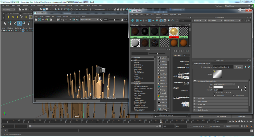

I recently make model and all good and nice view from render view. However, there is great different image of batch render and render view.safe.jpgview.png
As you can see, the fog created by volume primitives cube don't have in the batch rendered image.
Thanks for giving me advice to make them no big difference.

2 problems:
1. You did Batch Render with a different camera than Preview Rendering inside Maya
2. Maya Software Renderer does not wok correct with Color Management, so you may disable Color Transform in Maya Render View for a better preview.
