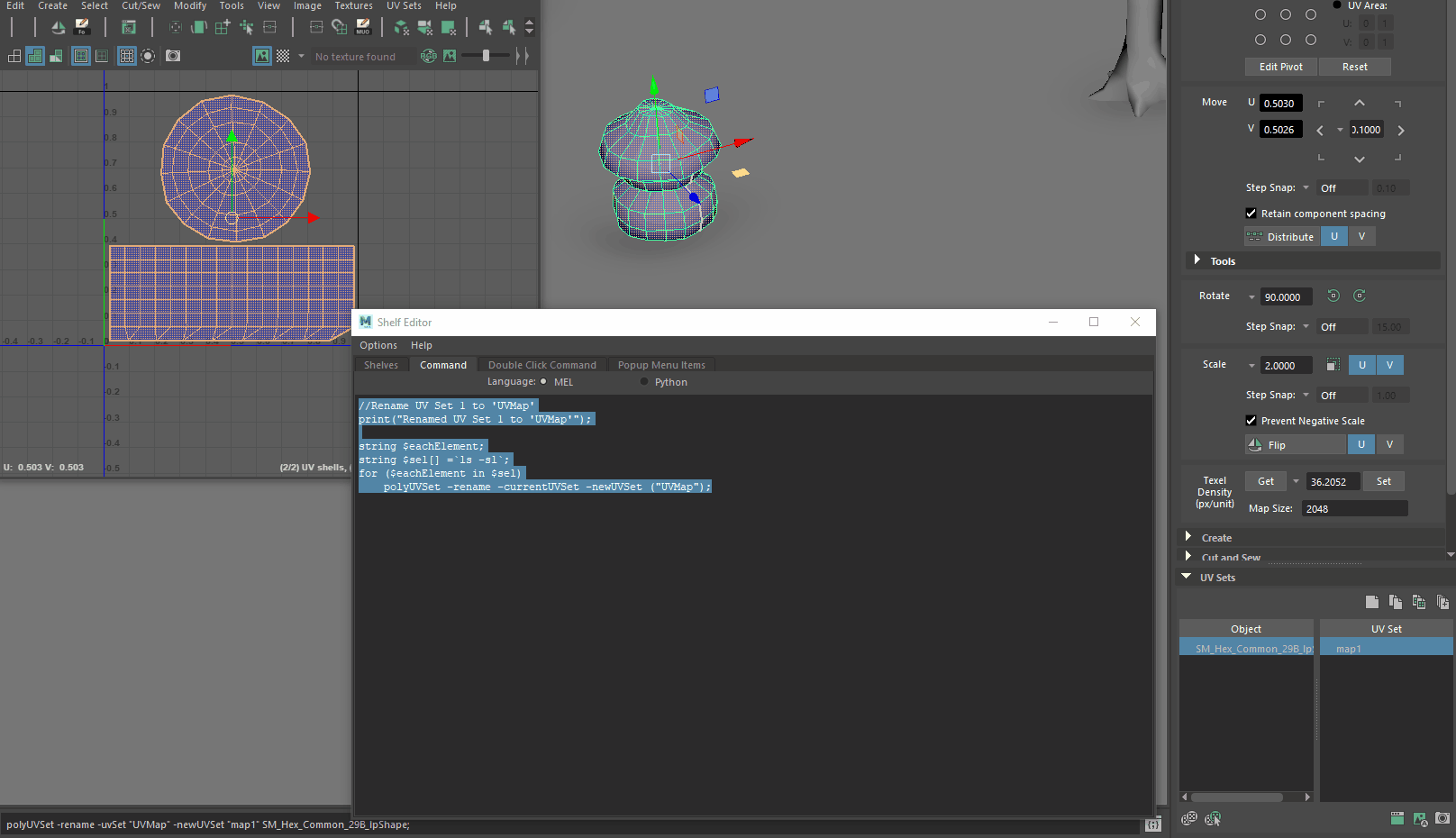

Hi there,
I am looking for improvements of the script I've assembled, in a way that would allow me to apply it on multiple selected objects without side effects.
Result I am after is having two uv channels containing the same layout and named regardless of initial condition this way:
UVMap
UVLightmap
Script thus far has 3 parts:
//Rename UV Set 1 to 'UVMap'
print("Renamed UV Set 1 to 'UVMap'");
string $eachElement;
string $sel[] =`ls -sl`;
for ($eachElement in $sel)
polyUVSet -rename -currentUVSet -newUVSet ("UVMap");
There is this one issue with that part:
//// Error: line 7: Cannot rename uv set to an existing uv set name.
Is one of selected object already has UVMap channel, it won't rename others.
Then I have creating UVLightmap and copying content from UVMap to UVLightmap.
//print("Created 'UVLightmap'");
{string $objects[] = `uvSetMakeSelectCmd`;polyUVSet -create -uvSet "UVLightmap" $objects;};
//{string $objects[] = `uvTkCreateUVSetTargets`;polyUVSet -create -uvSet "UVLightmap" $objects;};
print("Created 'UVLightmap' and copied content from 'UVMap' to 'UVLightmap'");
polyCopyUV -uvSetNameInput "UVMap" -uvSetName "UVLightmap" -ch 1;
So that causes situations of creating UVLightmap1...2.. if UVLightmap already exists.
Atm Part 1 and Part 2+3 I have split under different hotkeys.
Gif shows some of the situations. Generally it works, but requires to go through individual cases manually.
I am after selecting 50 assets and get the same end result.
Therefore also part 4 is needed, where would be performed cleanup from other UV sets than 'UVMap' and 'UVLightmap'.
Many thanks,
DS

Actually I think I sorted it out. I wanted "put all the uvs I'm looking at, regardless of what set it's in, exactly these uvs I can see on this selected geo, into map1 and delete all the other sets".
General cleanup for Maya. Not quite what you wanted but the checks seem to be working so you could likely modify.
