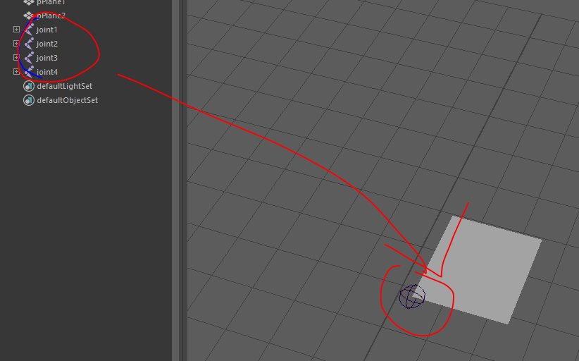

Hey guys I am new to maya scripting. I am trying to write a script that can create and constrain joints at selected vertexes. I found someone already done the creating joints part and i tried to "point on poly" constrain each created joints to each corresponding vertex during the loop. However the joints will all ends up constraining at the same vertex. What am I doing wrong?

Heres the screen shot
each vertexes are cramped into one single pointeach vertexes are cramped into one single point

Ah, I see, that does make a difference then. You'll notice in the original script that there is a $uv value being generated, which you don't have in your script. Your script will default its values to 0,0, which will in effect constrain everything to the same point of your object. When applying the script in the tutorial the way the $uv value is used relies on a nice even distribution of U and V with respect to the vertices. That's usually true for a nice regular shape like a plane but never true for irregular shapes like your ghost.
I would suggest playing around with those values to see if you can't get something more reasonable.

Not exactly, it's just reading the converted UV values directly with these two lines
  $vtxuv = `polyListComponentConversion -fv -tuv`;
  $uv = `polyEditUV -q $vtxuv`;
It doesn't work in general since there can be multiple sets of UVs and they may change when doing other operations but it is okay for a first pass.

Nice! I got it! My original ghost model did not have a proper uv map, and after applying proper uv map on the script reads it. this is enough for my little project now since it will be a rather simplistic model. ty for the helping!
