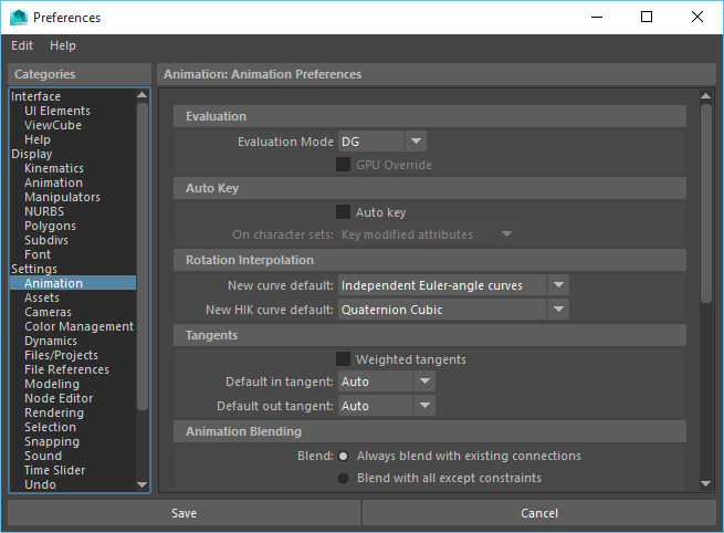

I've tested your scene. It looks like a bug. Using DG instead of parallel or serial evaluation would be better(almost no error).
I have logged this as defect in our system.
Yours,
Li
ShreddinPB
Where do I go to set that setting? I dont see it on the script nodes or in the expression editor.
thanks!
cheng_xi_li
Autodesk Support
Autodesk Support
It is in the preference settings.
