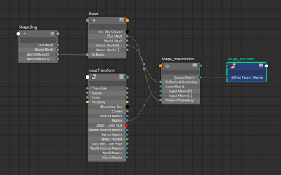

I cant seem to get any output log when looking up the command to perform a Proximity Constraint. Also couldn't find any api documentation on this.
What command performs a proximity Constraint?

The proximity pin is a bit complexer of a setup than the other constraints, it also has more options to choose from and the options will actually influence how the nodenetwork created by the constraint looks like. So there isn't a command to create this constraint.
The easiest way to script this is to create the proximity constraint with the settings you want, and then look at the node network and recreate it node by node using code. In most proximity pin setups there doesn't have to be much created since the proximityPin node handles all calculation.
As an Example:
I create a proximity Pin for a selected shape with a selected transform as an input, a new transform as output and no maintained offset. The Nodenetwork looks like this.
Now if I wanted to create the same setup in pyhton, it would look like this:

Now this code is something I just wrote for this in like 15 min, so it can certainly be improved, but I thought an example might be helpful.
I hope this helps!
