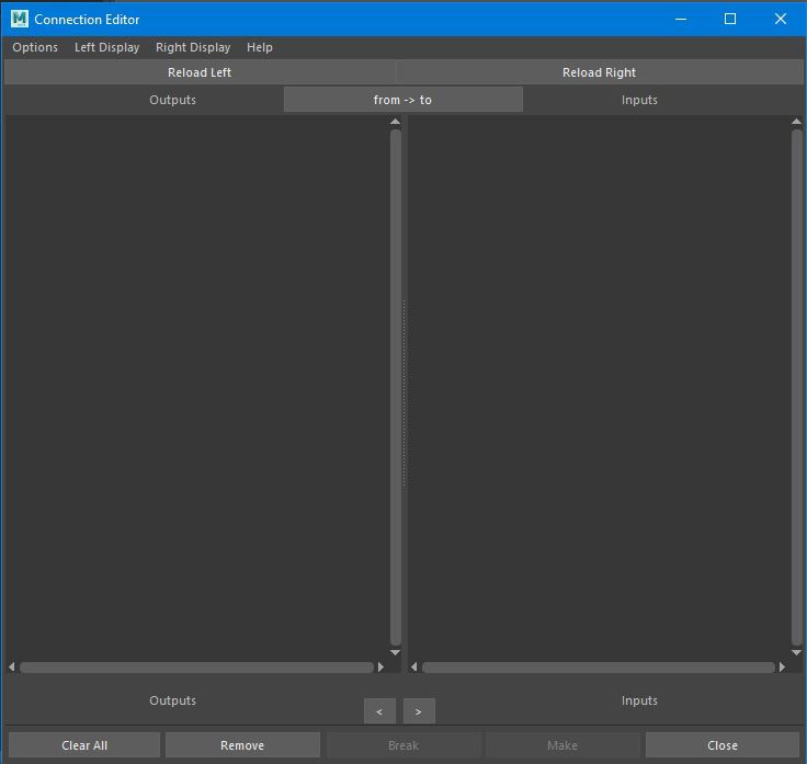

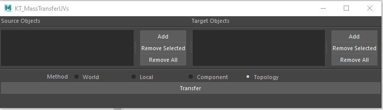

I took some time away from this UI, now im back at tackling this.
Heres my result.
Still not really able to create the effect i want. Currently the UI can scale Horizontally. But Wont scale vertically.

When I try to replace this
    paneLayout -configuration "vertical4" -paneSize 1 40 80 vertTopLayout;
    paneLayout -edit -paneSize 3 40 80 vertTopLayout;
with a rowLayout. The treeView disappears, leaving only the buttons.
However I found the layout that i want to replicate, at least part of it. which is the Connection Editor. But I cant seem to find the mel script for it, so i can study it. I like the fact that the whole UI is adjustable when you resize the window. In the Connection Editor case, they used nodeOutliner to populate the list. In my case Im using the treeView. Which works similar to Outliner list, without all the extra stuff.
