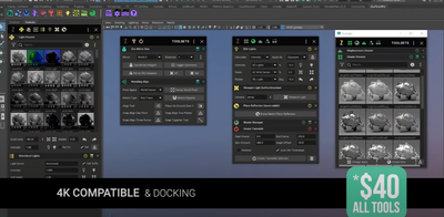

Hi, I'm currently making a tool for maya, and I wanted to level up my UI appearances.
I'm wondering how can I create a custom panel like this one, specially the main header with bigger and bolder fonts, different font types, custom buttons/icons, image previews...
Is there any documentation out there on this? Thank you.

Hi!
I'm not sure how much you can do using MEL, but you should find information to what you can and can't do in this doc:
https://download.autodesk.com/us/maya/2010help/Commands/cat_Windows.html
If it is a python program, the Library that is mostly used to created custom panels/UI Elements is "QT.Widgets".
https://doc.qt.io/qt-5/widget-classes.html
I hope this helps!
g2m.agent
This plugin should be written in Python, so its UI should be written in Pyside2. Maya has Pyside2 built in.
You can refer to this:
https://help.autodesk.com/view/MAYAUL/2022/ENU/?guid=Maya_SDK_Maya_Python_API_Working_with_PySide_in...
and you have to learn the Qt framework yourself.
