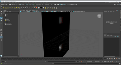

And another observation- the custom area light node and native area light node cannot be rendered in viewport at the same time.
The later created light breaks render pipeline. Does that mean it is still somehow an override of native area light?

when there is no custom area light in the viewport, native area light draws with native fragment (my custom fragment is red color only for testing) so i think it's not overrided.
Jialin
