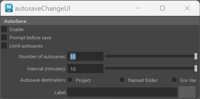

Hi! everyone.
I just created the UI using only python cmds. I am new to creating UI with commands, so please let me know if there is anything I should implement. The image above is the concept of the UI, and the image below is the actual UI I created.
it's a concept picture.it's a concept picture.what I made.what I made.
I am unhappy with the UI.
  • The UI does not line up nicely.
  • I would like to implement the ability to make the button icon for textFieldButtonGrp a folder icon and open the user's folder when clicked.
Also, how do I connect autosave commands to the UI? Do I have to use def?

I modified the UI as follows and it looks better. The difference is that cmds.checkBox was changed to cmds.checkBoxGrp.

My next wish is to change the appearance of the button in cmds.textFieldButtonGrp( l = 'Label', bl = 'Button' ) to a file icon. If not possible, I will accept the current button appearance.
I also need to create a checkbox to enable and a checkbox to disable to make it work the same as AutoSave in Files/Projects in Preferences.
My intention is to do this as far as I can on my own, but I would be grateful for your help.
