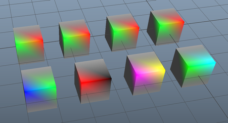

Instances share the same shape node and the color per vertex is stored in the shape. That's why all instances show the same vertex color.
When you *duplicate* the objects then each object (shape node) can have its own colors.
front row: duplicated objects = individual colors
back row: instanced objects = shared colors
