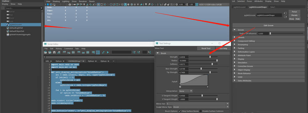

Hello, everyone, how does python control the properties in the secondary window? I use (cmds.ls (SL = 1, Dag = 1, s = 1, type =' pgyetigroom') to perform object properties, and the result is No object matches name. How can I enter the secondary window through python?17288fde96cb9d8a3bb6fe9b93f96a4.png
I write a script for reporting errors.
import maya.cmds as cmds
import maya.mel as mel
def yeti_display_seting(option='brushRadius'):
    sel = cmds.ls(sl=1, dag=1, s=1, type='pgYetiGroom')
    if len(sel) > 0:
        pgYetiGroom = sel
    else:
        pgYetiGroom = cmds.ls(type='pgYetiMaya')
    for i in pgYetiGroom:
        if option == 'brushRadius':
            cmds.setAttr(i + '.brushRadius', 5)
cmds.window( title='reset')
cmds.columnLayout()
cmds.button(l='reset', c="yeti_display_seting(option='brushRadius')")
cmds.showWindow()       ​
I found some code about this window in the plug-in script.
def pgYetiGroomContextProperties():
	parent=str(cmds.toolPropertyWindow(q=1, location=1))
	cmds.setParent(parent)
	combContext=str(pm.mel.pgYetiGroomContextNameQuery())
	# create a "global" tool collection for our tools
	if cmds.toolCollection('pgYetiGroomToolCollection', exists=1):
		cmds.deleteUI('pgYetiGroomToolCollection')
	cmds.toolCollection('pgYetiGroomToolCollection', gl=True)
	cmds.setUITemplate('OptionsTemplate', pushTemplate=1)
	# create the top-level layout.  This must have the
	# same name as the string returned from getClassName
	cmds.columnLayout('pgYetiGroomContext', adj=True)
	parent+="|pgYetiGroomContext"
	cmds.frameLayout('pgYetiGroomBrushFrame', cll=True, l="Brush", cl=False)
	cmds.columnLayout('pgYetiGroomBrushLayout', adj=True)
	cmds.floatSliderGrp('brushStrength', min=-1.0, cc=lambda *args: pm.mel.eval(("pgYetiGroomCtxCommand -e -brushStrength  " + combContext)), max=1.0, ann="Brush Strength", label="Strength", field=1)
	cmds.floatSliderGrp('brushRadius', min=0.0, cc=lambda *args: pm.mel.eval(("pgYetiGroomCtxCommand -e -brushRadius  " + combContext)), max=10.0, ann="Brush Radius", label="Radius", field=1)
	cmds.floatSliderGrp('brushSoftness', min=0.0, cc=lambda *args: pm.mel.eval(("pgYetiGroomCtxCommand -e -brushSoftness  " + combContext)), max=1.0, ann="Brush Softness", label="Softness", field=1)
pgYetiGroomContextProperties()		​
