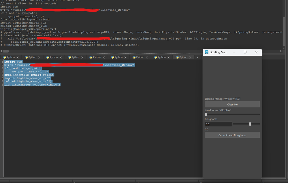

Hello I'm am a newbie when it comes to Python and coding for Maya. I'm using PyQt pyside2 for the first time to create a custom dockable window that will help with lighting. Such as bringing the roughness control slider to the window so I can adjust it without having to dive all the way into the shader.
I'm able to create a slider that affects the roughness but I want the number of the roughness to be displayed live so you see what it is currently at. On line 99 I added a line of code that I thought would update the number on my window every time you moved the slider but I'm getting an error that says: # RuntimeError: Internal C++ object (PySide2.QtWidgets.QLabel) already deleted.
I'm not sure if this has something to do with Python's garbage clean up or with the way I'm deleting and recreating the UI? Or is there a different way that I need to parent things? I'm not sure what I can do.
My code is below, any help is much appreciated, thank you!
