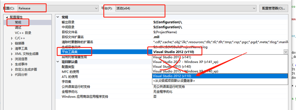

Maybe i konw the reason why it cant work. i use vs2017 build for maya 2017, also i change the code of hello world. Then i found cout cant work.
so i use the vs2012 that mentioned at maya2017help,the cout work.
then i change the toolkit of vs2017,it's also worked.
so it maybe the MS change the toolkit without saying anything about it.
