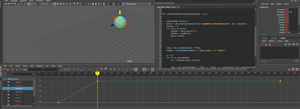

By default the script works without animation layers.
I would like that someone could incorporate the option to make it work in animation layer, to incorporate the keys in the animation layer only and not in the animation base, only if there is a layer that adds the new keys to the layer and not to the animation base.
And if there is no layer that works in the animation base only. To detect if it has animation layers is what I am looking for.

Hi!
I'm not gonna lie, what you are doing with your "buffer" variable is a mess and I don't know what exactly you are going for there.
I had to remove the attribute flag from the setKeyframe command to get my test working with animation layers since you were referencing the inputB argument on the animation layer with it which is unkeyable...
I'm assuming that you are using this to find out what curves are displayed in the graph editor, I'm not sure why you aren't using the solution that uses the animCurveEditor command that I posted here just a few days ago. I'm also not sure why you are looping through all selected channels to just use the last one.
Anyways, I kept my hands from that, this is the code that you would need to do what you are asking in this post. Set Keyframes on relevant animLayers if they exist, set them on base if they don't (given you get the buffer stuff working with animlayers):

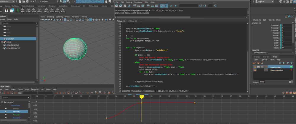

dg3duy
@Kahylan these days I've been trying to make it work all together and I haven't been able to make it work...
Kahylan
Ok...
So in your video the indentation level is off, and I don't see the logic of getting the attribute, so I can't tell you what is going wrong there.
The biggest problem is, that you are keying ALL the animation layers except the base layer, instead of just keying the curves that are visible in the grapheditor, which would be simple because you can just feed the the setKeyframe command the animation curve and don't have to worry about arguments:

This is a lot of additional work and computation for something that is in my eyes a counterintuitive mechanic. Since I would not expect to have keyframes on layers that aren't selected in the graph edior if the graph editor selection plays a role...
I hope it helps
dg3duy
My mind explodes with the options you have incorporated, a lot of study material. Case solved, thank you very much!
