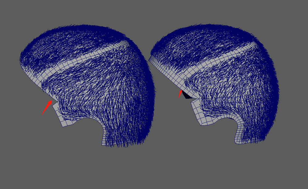

I'm just going through a tutorial on how to bake texture maps in Maya as I've never done it before. I also want to see how the Normal map bake fares compared to what I was getting in Marmoset Toolbag, which was showing some issues. I'm just trying to bake a high poly hair cap to a low, however, after setting everything up correctly, as soon as I hit Bake and Close, I keep getting an error saying Error: line 0: No object matches name: cap.
My low poly is called hair_cap_low and the high is hair_cap_high. I've tried deleting all the history - Delete All by Type > History - freezing the transforms, going to Optimise Scene Size and selecting everything, saving as a .ma file, exporting out the meshes and adding them into a new scene, but I get the same error every time. 😕

我是水~
我下载了上面的模型,发现了问题是存在于UV的命名上的,将hair cap名字修改就可以正常的烘培了(我估计是存在了无法识别的特殊字符所导致的)我标记了下截图可以看下,或者我录制了视频可以进行参考

t_smith5
I got it to work! 😄 Thank yoooouuuu. You're a genius! I tried changing the name of the UV to something simple like 'cap' and it worked. 🙂 Although, I don't understand why the original name didn't work. You mentioned 'special characters', but there weren't any. There were no underscores or numbers. At least, not on my end. It was just called 'hair cap'. I'll see if adding an underscore works.

我是水~
太好了,能帮助到你真的太棒了
关于法线(N)的原因其实是因为高模和低模是完全一样的,而且高模也没有封口,这样子完全一样的高度的片叠在一起就会导致MAYA算法上出现接缝。解决方法就是将高模多挤出一些就行了,像我下面的截图一样。

t_smith5
Sorry, not sure if it's my translater, but you did mean the high poly that you have to expand slightly, right...? Only I tried that and the same issue happened. I also tried it with the low, but that makes the issue worse. 😕
