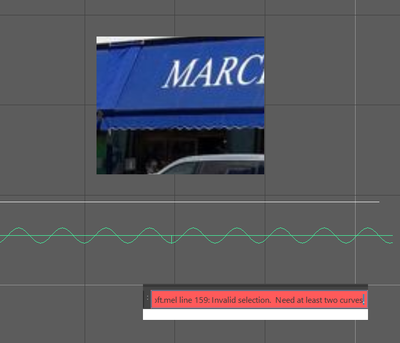

I am trying to make some blind fabric and I used the wave deform tool to get a realistic result.
But when I try to loft it, Maya doens't seem to consider it as a curve.
Do you know how I could do this cool wavy fabric look ?
Thank you for your help.

Hi!
As can be seen in the error message you need a second curve for loft.
