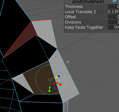

Im getting weird faces when im trying to extrude a plane. Can anyone help me?

 I am not sure, but it looks like you have 2 set of faces on top of each other. It happens when you execute the extrude and you loose the selection of faces and then you select them again and extrude. Now you have 2 sets of faces on top of each other.
I might be wrong. Upload your scene , someone will take a look.

Tried to reproduce the results:
Seems like you have accidentally extruded one of the edges. Can be easily done without noticing if your Move tool has Shift+Drag option enabled. Dump that setting!
Now, you either delete those extrudeFace nodes and then check if there are hidden (zero geo area) faces, or run some Mesh>Cleanup to hunt for those. I'd say, once you notice such weirdness, undo the action and fix the geo.

jean.horlaville
Thanks, i indeed had this setting on... But i actually fixed my issue by selecting Display -> polygons -> face normals.  And then i just deleted every single edge of my mesh to make sure there wasnt any double (doing Ctrl Z if the edge disapeared). It took quite a bit of time, i guess your solution would have been better
