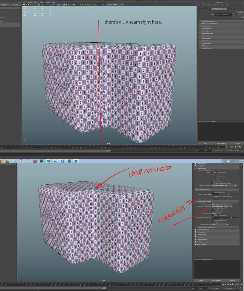

damaggio
UV_Stretch.jpgIt worked, they are all square as it should be, now you have a different problem because you are using SubD.You need to adjust your OpenSubd settings.
javimartiruiz
Thanks, it worked!
