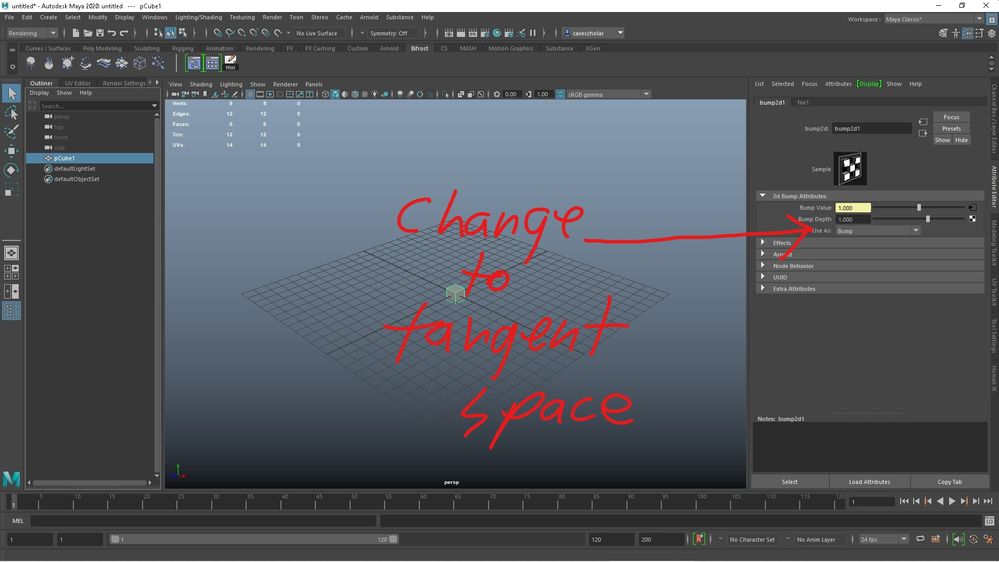

Message 16 of 21
cavescholar
Message 17 of 21
mspeer
Hi!
The space needs to be set at the application where you create the UV maps.
In Maya it's in
Transfer Maps -> Output Maps -> Map Space.
However I tested to bake this here in Maya too and your settings are correct for Tangent Space.
I just was wondered because of some of the colors in the map, which seem to be caused by extreme angles of your surface.

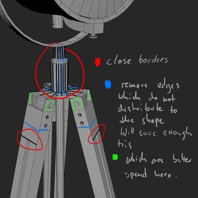

It might be i´m repeating something which was already said but i made some pics to explain some of your problems:
and keep your meshes exploded like you had it in the beginning when baking in maya  or name matching for substance to prevent you from unnecessary artifacts.
