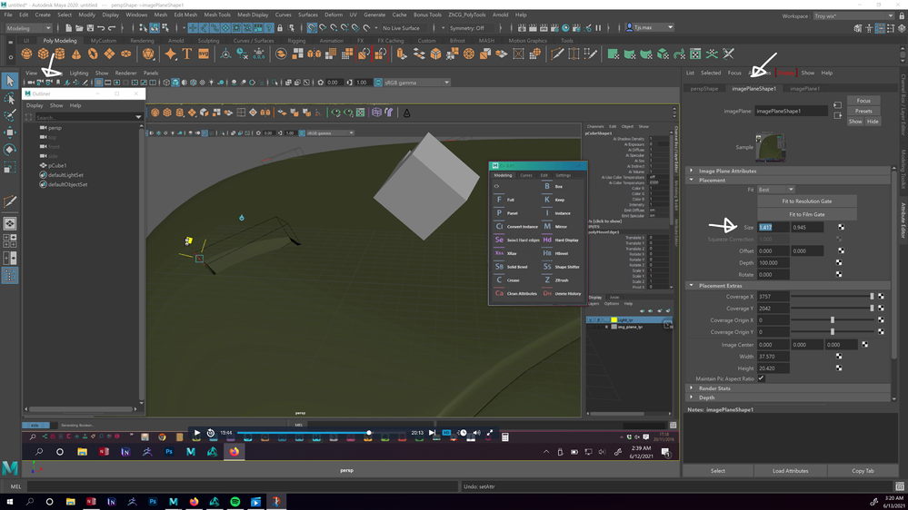

The only way I know how to scale an image in Maya is if you use image plane, if you have go into the camera settings which will open up the attribute editor.
In there you will see a tab named imagePlaneShape1 click on that and open the placement drop down menu
In the placement drop down menu you can change the size (how big or small you want the image), offset(move left or right), depth(zoom), and rotation
I've included an image to help, as for the substance painter issue I'm not aware on how to help you out on but good luck!img.png
