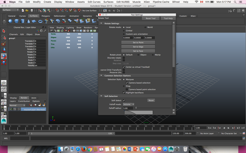

For the love of God I have been on this software for 9 hrs and I been trying to figure out how to rotate a polygon and it is not working. CAN SOMEONE HELP ME PLEASE

Can u show what object /face you are trying to rotate?

damaggio
In the Tool settings, click the Reset button and try to rotate the object, or select a face and try to rotate, make sure soft selection is disabled.

No it is not working. I even had other polygons to the panel layout and that too is not working. I am using the hotkeys. I click W and R both are working fine is just when I click on the E to rotate it doesn't seem to want to rotate.

I there. I had to ask my prof and she explained to me how to get it to work.
I go to WINDOWS- PREFERENCES-KINETICS- CLICK EDIT- CLICK RESTORE DEFAULT SETTINGS and it worked
Thanks for your help though.
